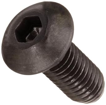

Going to use something like this for assembly
