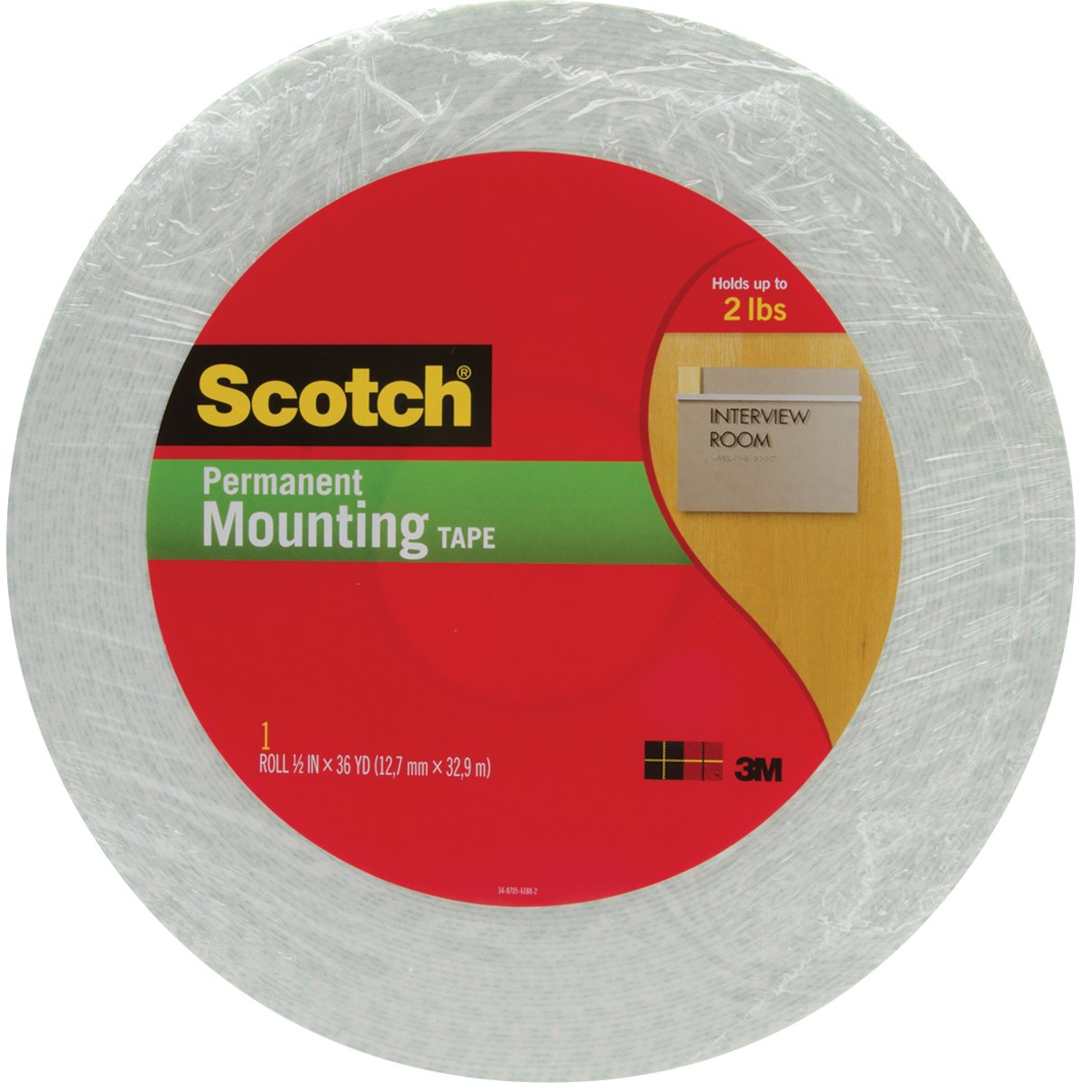

The lights come with an adhesive backing , but I'm worried in the long run they will just fall off the plastic interior pieces I intend to stick them to. My question is: What would be the best way to permanently mount the lights to the plastic interior? I was thinking using some JB Weld plastic weld , or even zip tying them to the plastic ... any thoughts or tips on mounting lights inside would be appreciated ...
RobRed
3m Exterior mounting tape - 5lb. is much better than foam tape for automotive.
I use it all over the place including the 20" LED mounted to my back hatch.

I have done this in my syncro and my mog. Get some 3M VHB tape. You can get it in several widths and it does the job nicely.

I used one of the double sided tapes, but am forgetting the exact model. I think it was a VHB variety from 3m.

I also put them into the roof of our old camper shell. The original doubleside-tape said 3M, but was what you can expect for 5m on the back of a 10$-LED strip.
I used real 3M (indoor), and it stuck even to the carpet of the shell. So basically any "normal" foam tape does the job. The outdoor one is pretty good, I agree with Rob. If you want something really sticky, get the VHB 4991 on Amazon. It's the stuff that comes with the GoPros and is basically unremovable. Probably overkill for an LED strip and close to unremovable. If you want some inches to try, anytime... I have a 5yd roll and not used it yet (Next Campbell meet - when would that be?).
