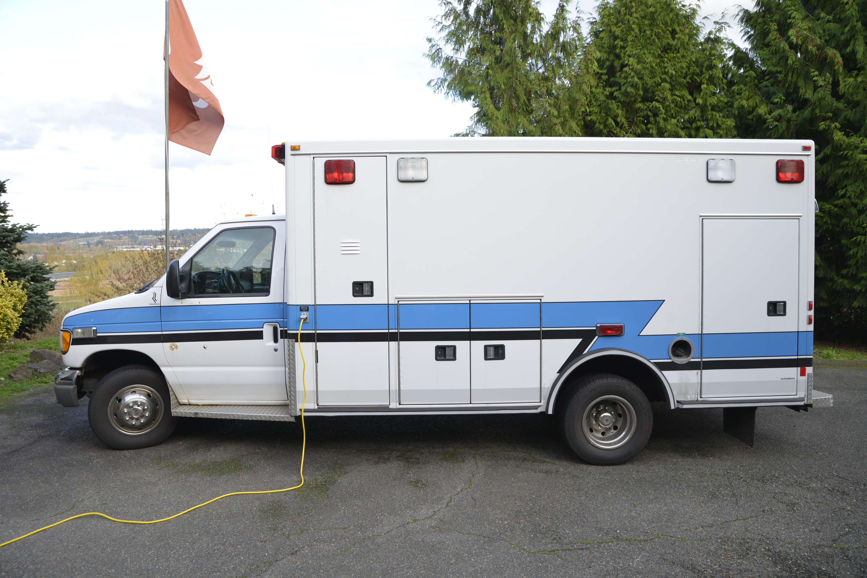

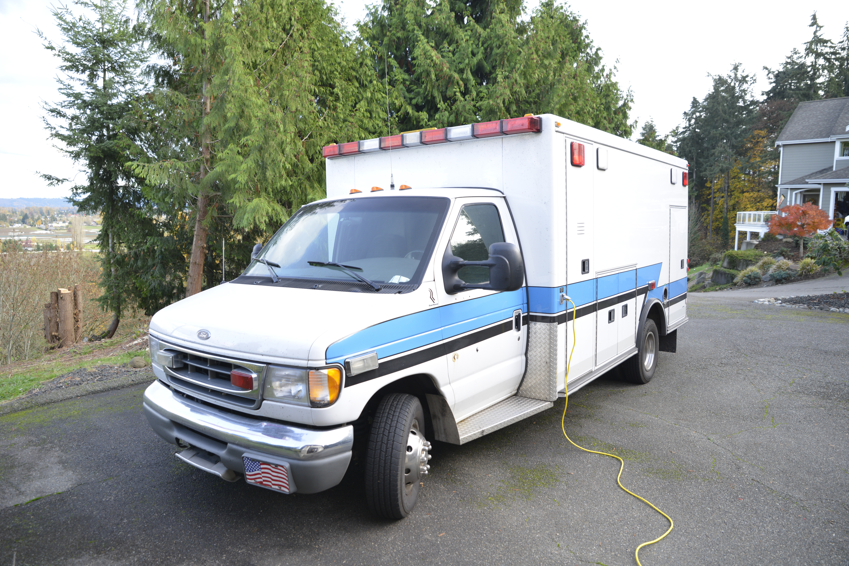

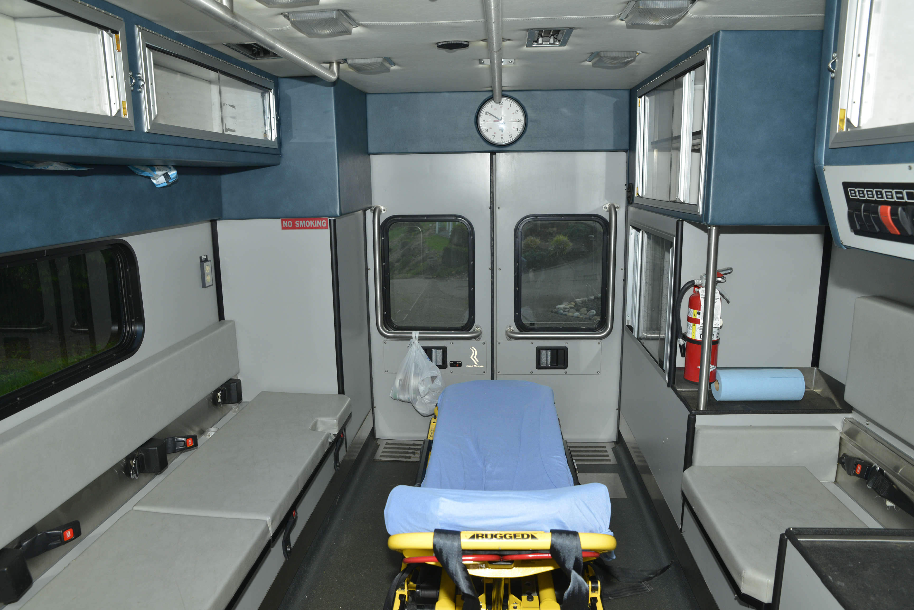

So I've got my hands on it and have some pictures. I just drove this thing from Wisconsin to Washington State.

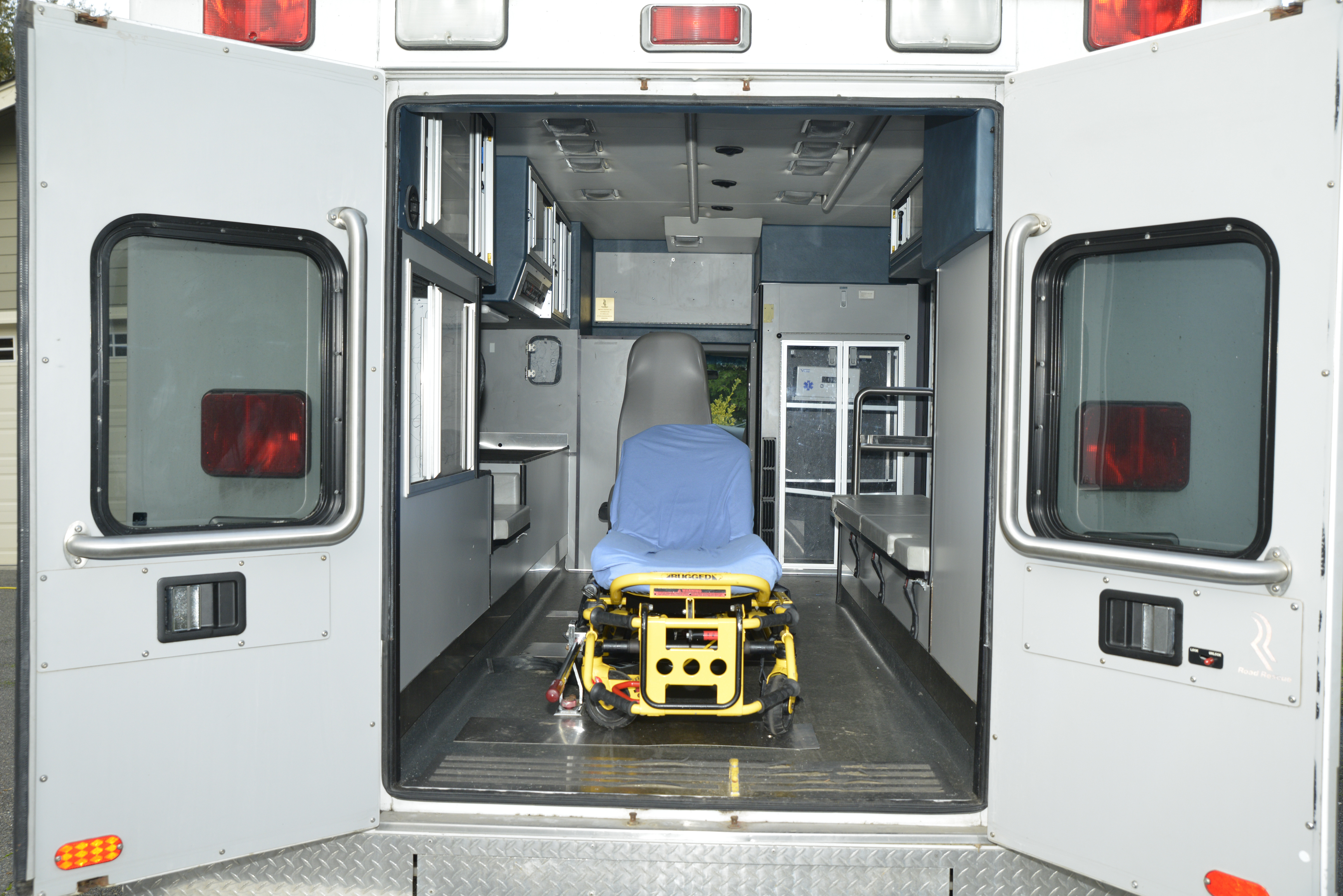

The stretcher came in handy in that it saved me a few bucks on hotel rooms. I'm ready for a real bed though. Ebay suggests that the stretcher may be worth $1000-$1500.

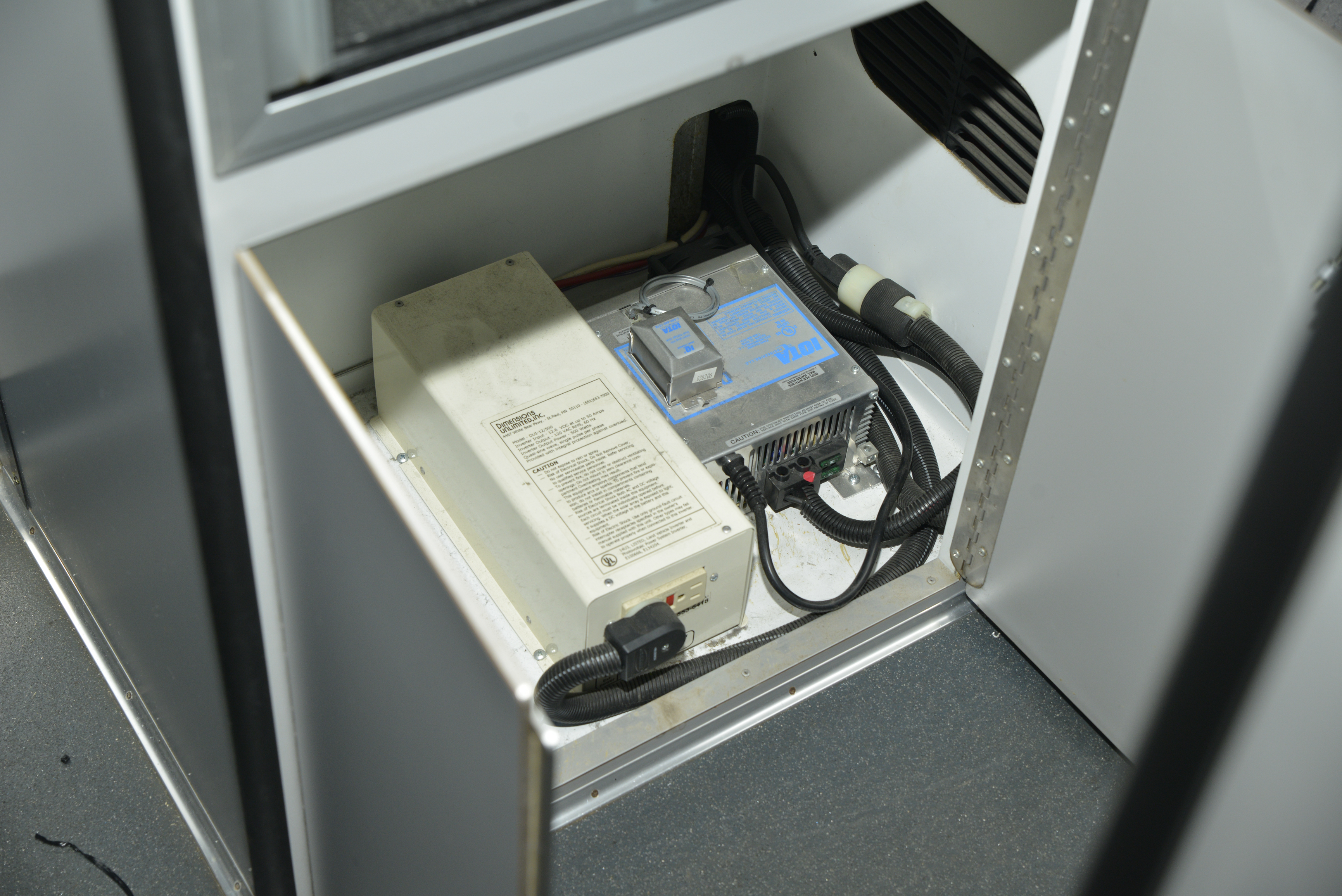

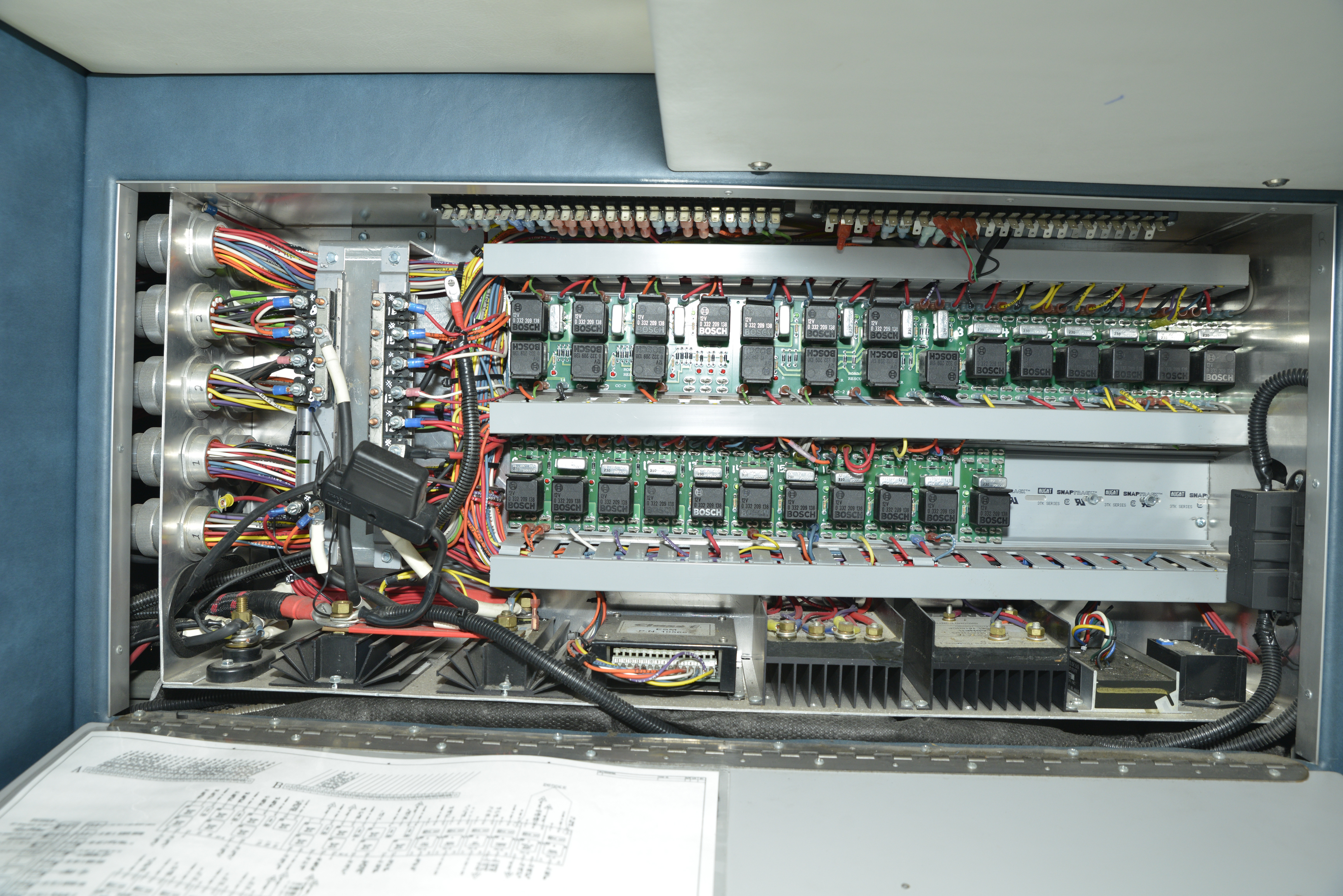

I'm liking the look of the power system in that it appears to be easily reconfigurable. It's got three batteries in the front lower compartment on the passenger side and no battery under the hood. I'm going to have to figure out how to either add a battery back under the hood or separate one of the three so I can run the electrical in the module without the motor running. As it's set up now everything shuts off about 10 minutes after shutting the motor down. It has a 110 inlet that appears to do nothing other than power a few outlets in the module but none of the lights. I'm fairly ignorant when it comes to electrical systems so I've got a lot to learn.

Two of the batteries should be isolated from the others. Is there annother battery on the Passenger side frame rail?
The house power is reliant on an input from an oil pressure input (at least with mine... And they tend to be fairly standardized). If you bypass it, you should be able power when the engine is off.

I thought two of the batteries should be isolated as well. Doesn't appear to be the case though. There isn't another battery under the frame rail. I saw that somewhere in the manual that there should be one just forward of the rear passenger side wheels. Nothing there though.
The seller told me the house power was on a 15 minute timer. I can also power it on if I turn the ignition to the on position without starting it.
Bikersmurf
I see. Mine had to be running... Before the it stopped working and I rewired it to be on whenever I switched it on.
For isolation I'd recommend a Blue Seas ARC battery isolator. I'd also add a second starting battery to the P/S frame rail.

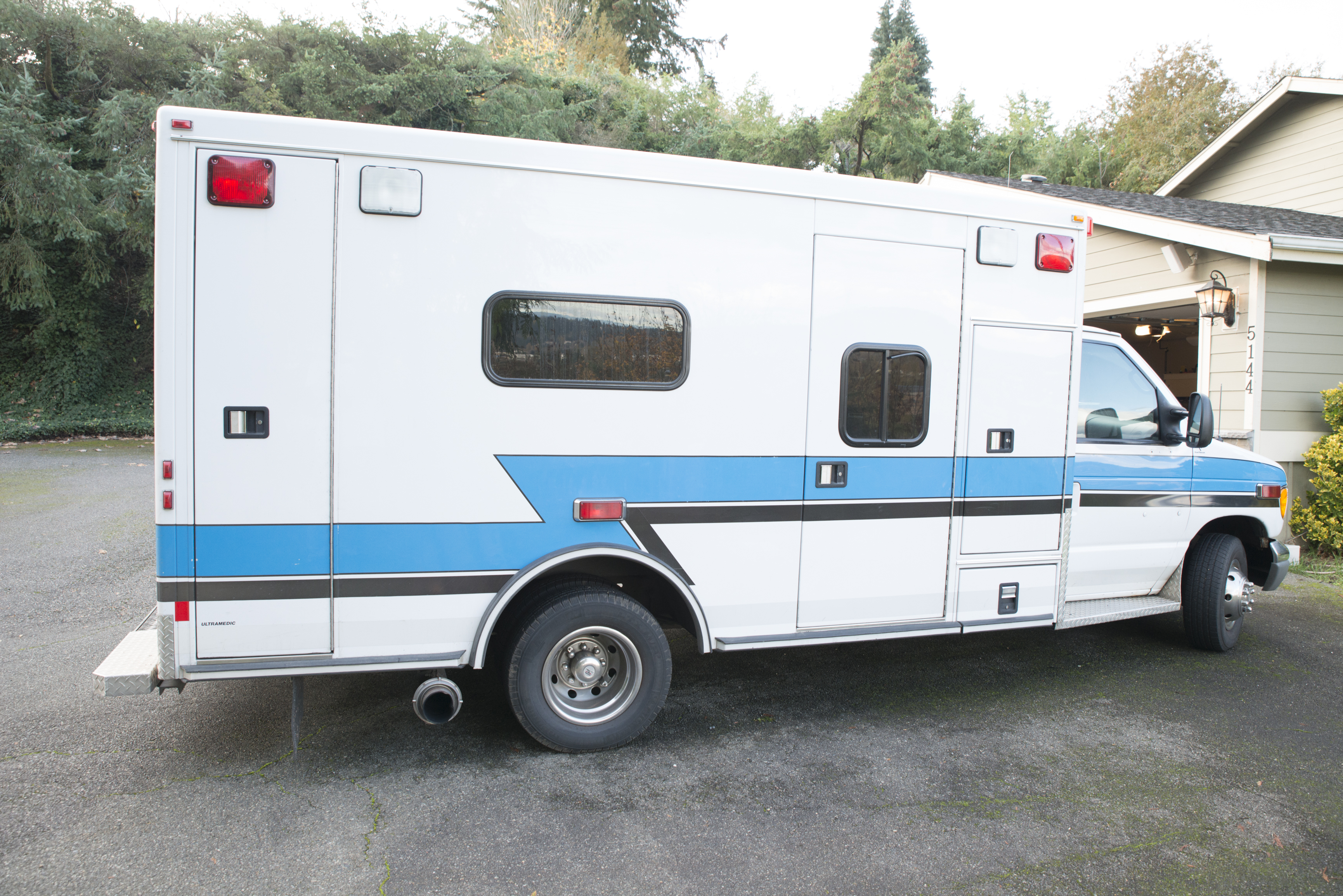

Looks like you have a Road Rescue with a similar box build as I do. you'll find it's very strudy. The box layout is different. That passenger side box window is great.
For the sake of cash flow, you can do what I did and leave the box and cab white and paint the blue strip (Crimson in your case). Get a decal, preferably custom, and throw it up on the side of the box.
Use the CO2 tank compartment (tall skinny on driver side just behind the driver door) for tailgate canopies and chairs. The compartment behind that is a great bet for a generator. The rear most compartment is a good utility compartment. That's where you store the propane tank, freshwater tank, gray water tank, tools, adapters, extension cords, etc.
Your house (box) batteries are located in the smallest outside compartment on the passenger side, the one all the way to the front of the box and below the larger cabinet door.
If your batteries shut off after 15 minutes, and they're aren't dead (if you cycle the key in the ignition) they are certainly on a timer. This is likely to keep them from draining should the driver/medic shut off the rig and leave the rear power on. There should be two deep cycle batteries in there, and two batteries in your engine bay.
Look around to see if you have a batter maintainer/charger. If you do, when you plug into shore power (the 110 inlet on the driver side) it will charge the batteries as well as power the 110 outlets in the box. If you do not have a generator adapter built in you can simply plug a generator into the shore power when camping or tailgating.
