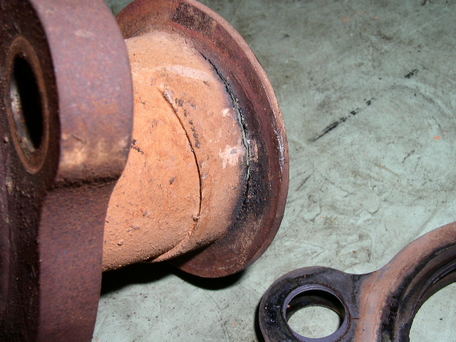

Also, here's a pic of the exhaust manifold issue. The flange is thin and tends to crack. The infamous "ticking" is a good sign, your manifold is cracked. As yourengine warms up, the flange expands and end up hearing less of the "ticking".
hmmm....I've noticed mine making a ticking noise and the drivers side manifold seems to move a little.....another project.....thanks Mike :)!
