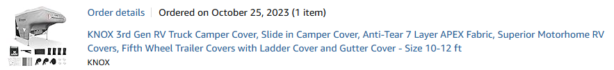

I bought one of these because they are shaped to fit a slide in and there is a zipper for a rear door. Only problem is it fits too large for my camper. I haven't decided if I am going to cut it and sew back together or just get rid of it. It definitely too large as is to even try to make it work.
cover
it doesn't appear to be on Amazon anymore.
