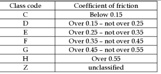

I am not super familiar with commercial/truck brake materials. Most pads/shoes for vehicles in the USA use the SAE two letter code system (via SAE J866 spec). The first is the cold friction, the second is the hot friction.
So a DG code pad would have 0.15-0.25 friction at temps between 200-400, and 0.45-0.55 at temps between 300-600F. The higher the friction coefficient, the more stopping force is generated for the same pedal (or actuator) force.
Not all listings show the friction codes (if present), but they can sometimes be seen in the photos of a listing.
Here is a random shoe, its hard to see, but one of the lines ends with FF.
