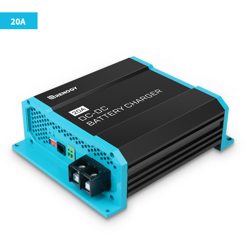

I just recently met a guy boondocking who is working out of his customized camper, who had built, installed and configured his own LiOn battery system for working via computers while on the road for the next year. He even built his own batteries.
He patiently took time to (try) to explain to me exactly how the system worked and although I understood very little of what he said ?, it did stand out to me that he stressed you can’t charge lithium batteries from your vehicle’s alternator like you would regular rv batteries.
Anyway, maybe check these guys out?

Any DC to DC converter will reduce the amount of Amps the battery can receive unless you spend big bucks to get something that allows for 150a or so.

Some good info in this thread. A battery to battery charger (Redarc, Sterling) is probably in order.

Now that I have finished the construction and run it for almost 3 years, you cannot hook directly to your alternator. I installed a DC-DC charger limites to 60Ah. Because the LiFePO4 batteries are like a black hole. They will absorb every current available (almost, depends on the BMS). So, when the truck is idling, the alternator will overheat. It tries to deliver the max Ah possible.
