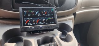

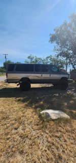

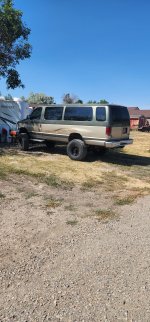

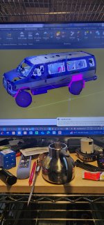

Hi all.. I'm all about full size & half size... let me introduce "Chupa Cabra" 1/2 of my rig.. she started life as a 2002 Econoline 7.3 powerstroke.. so far she has been converted to 4x4, lifted, converted to manual tranny with electric gear vendors overdrive running on 37's .. manual transfer case.. with the lift I will be mounting exterior door chassis mounted tool boxes above the rear tires using the wheel well humps wasted space.. one each side

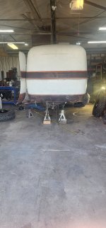

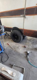

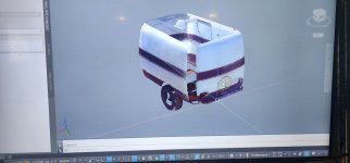

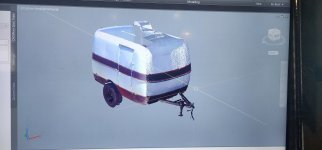

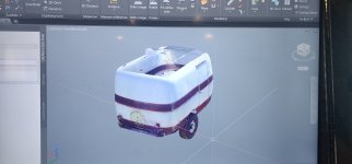

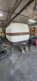

this week started on Nelle. a 1976 Scamp 10ft trailer.. which will be my offgrid office.. just finished the lift with 31's on independent suspension with ebrakes.. Within the next couple weeks she'll have solar, shore power, and dc to dc charging from the van to charge custom 52v 200ah li-ion batteries I am building.. the office will house my computer thingys.. power modules and stuff.. lots of stuff...
