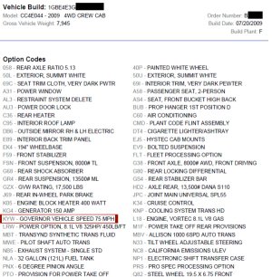

I'm not sure if you consider 2009 'modern', but my 2009 C4500 Kodiak came with option 'KYW', limited to 75 mph.
Of course upgrading from 225/70-19.5 to 385/65-22.5 increased the tire diameter by 24.4%, so now a theoretical top speed of 93+ mph (of course I have never verified that on pubic roads)
