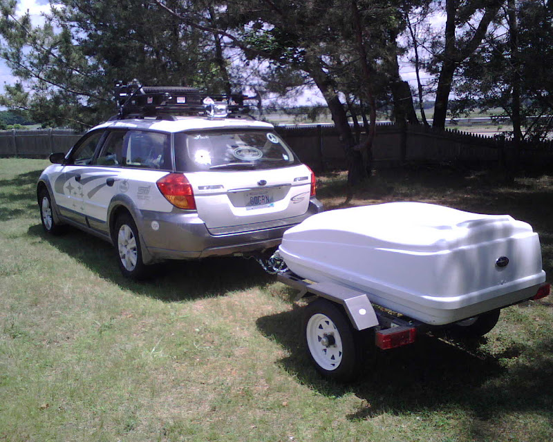

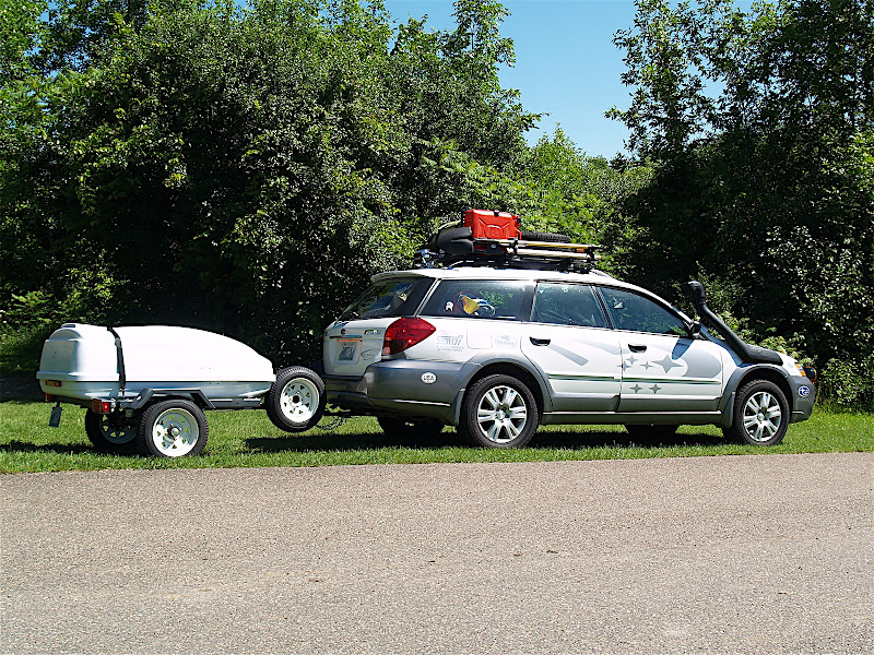

I built this one for under $300 complete from new parts. Granted, it's not gonna go with you on the Rubicon, but it does well on fire roads and moderate trails to get to campsites and fits tent, sleeping bags, etc. nicely.
Superu
It's the HF 40" x 48" with upsized wheels and a 20 cu. ft. Sears X-cargo painted with Krylon for Plastic.
Planning to put a piano hinge on it to let it open from the side rather than back to front, but it works well as is.
I painted the trailer to match the grey metallic trim of the Superu before assembly. I also took one of the leafs out of the springs since it was a bit too bouncy for the weight I usually carry in it.
It's a nice little starter and serves my purposes until I can afford an AT with a RTT. I used a set of waterproof LED lights from West Marine on it for the occasional water that it sees.
Also repacked the bearings with decent grease since they came with little more than vaseline in them!

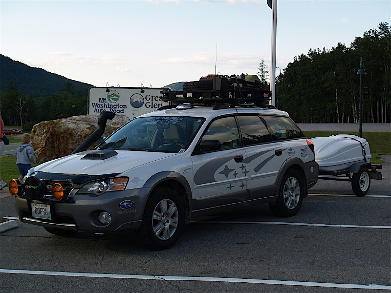

Put about 1500 miles on it late last summer through NH, VT and Canada camping with the wife and kids. :1888fbbd:
South Hero Island, VT
Mount Washington - pre light bar
