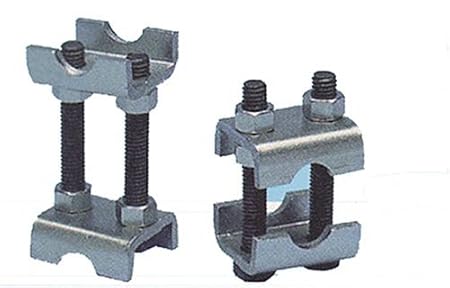

Would this 2.5" thing work? It says it's "universal" and looks like it'd be easy to just slide in there:
http://www.jegs.com/i/JEGS-Performa...ap3rVykrRde2P9GIOPLtUNNUiP5n_y-RoCclsQAvD_BwE
I tried them on my Subaru Outback before I got the spacers for the top of the struts. They did not work at all, slipped out too easy. If you have struts, you may be able to fabricate similar(to the Subaru) spacers for the struts out of metal or more easily out of HDPE.
