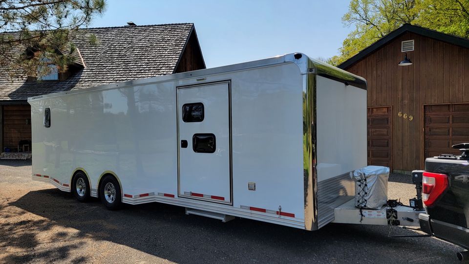

This build is a luxury trailer / toy hauler that has taken almost 12 months to create (built by professional custom camper builder). Far superior to an Airstream for less price. Base trailer is a Featherlite car hauler which is the best possible trailer to use with all aluminum oversized frame, aluminum floor, walls and roof and oversized tires with torsion axles and electric brakes on both sets of wheels. Entire trailer and cabinetry/interior walls are all made with aluminum extrusions (80/20). Since this was our first trailer build (instead of a van) we aren't looking for a profit so it is a great opportunity for someone. Garage area is 8 feet deep by 74.5" wide and 70" high (when bed raised). If the interior door is removed or left open, longer items can be stored. Removing tool cabinets would allow for 8'3" width.

- 2022 Featherlite 8.5' x 28' Aluminum Car Hauler (7' interior height)
- .040" White aluminum bonded exterior panels (extra thick)
- .032 seamless aluminum roof
- 12,000lb GVWR - Dexter Torflex axles with brakes on both axels
- 235/80R16 Radial tires on aluminum rims (includes spare on matching rim)
- Rear skid plate
- Rear spoiler with load lights
– LED exterior lighting

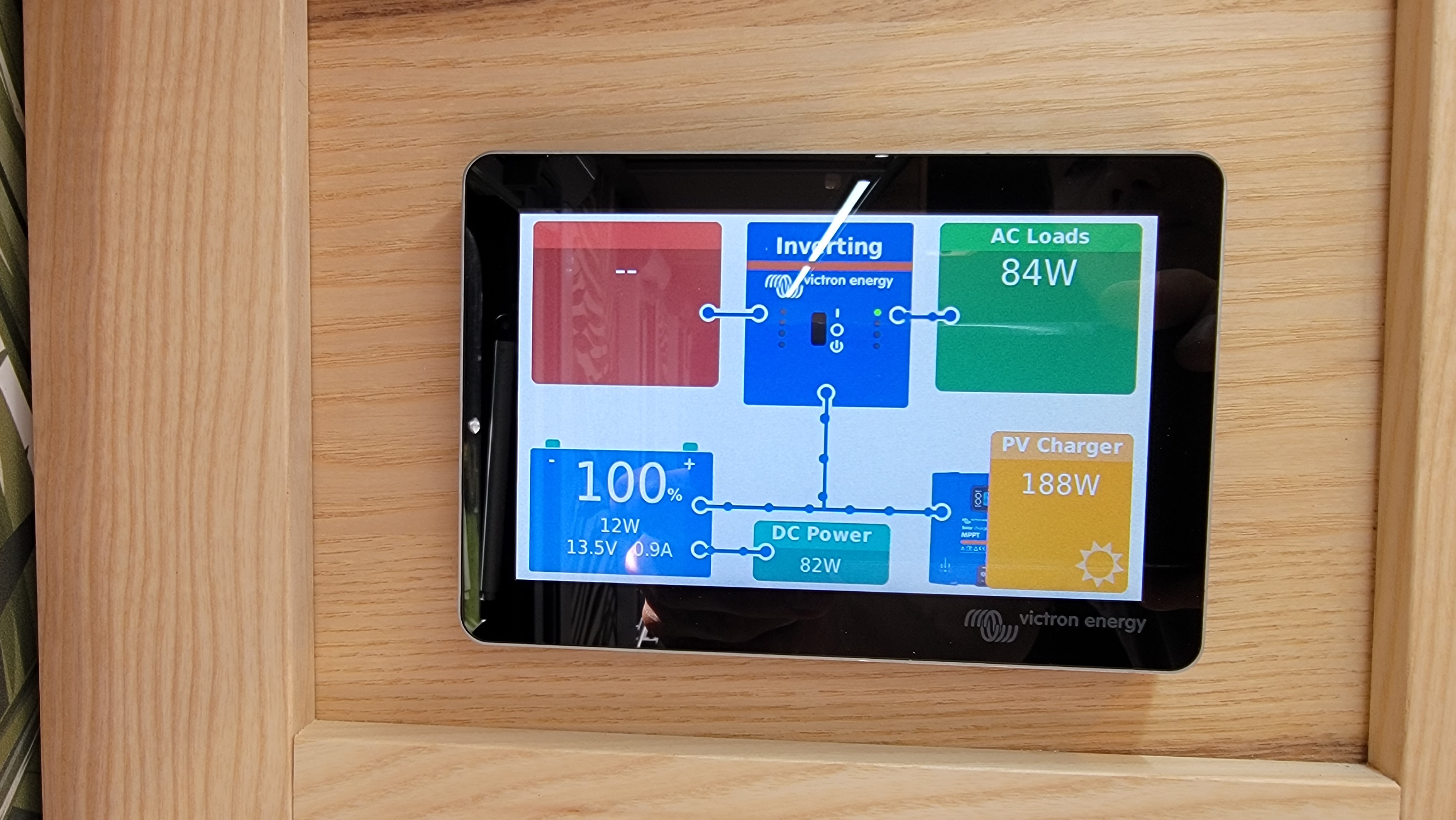

- Full VICTRON electrical package (3k watt inverter, 2x30 amp solar MPPT controllers, Cerbo GX, Multi touch remote display, Lynx distributor etc...)

Thanks! I weighed it at CAT scales on the test run after it was completed and weight with some luggage was 7,000lbs.
Sent from my SM-G998W using Tapatalk
I towed it with an F150 and a Mercedes Sprinter SRW and both towed it easily.
