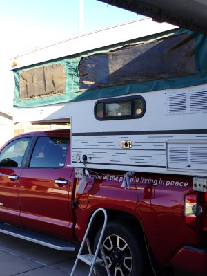

My current set-up is pretty sketchy, it consists of a bone stock 2018 tundra with a 1500# (roughly) pop up camper thrown in the back kinda willy nilly. I'm slowly building up the rig as my budget allows and I'm at the point where I have too many options and it's getting overwhelming. For reference the truck is about 5300 lbs empty and around 6880 loaded with a 7k GVWR. So I'm not overweight total, just a bit over payload and rear axle rating. The truck supports the weight okay, I'm not super squatted or resting on bump stops (although it's kinda close, like 3") I'm just looking to improve ride quality, like eliminating the bucking from the rebound and reduce body roll/ improve stability.
Picture to show the level of squat as it currently sits.

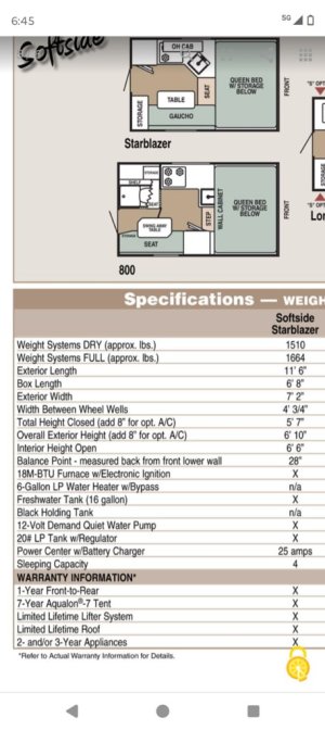

I need a little more information. I understand what you want to do, but I need more information. To specify I need to know how big the Camper is. Does it fit perfectly in the bed where you can close the tailgate? If not how far does it hang out? Pictures are great too.
Here are the specs. It hangs out about 6" beyond the box but I have it resting on 4X4 that are placed over the bed supports so the tailgate is not taking any of the weight. I've also removed a few things like the water tank so the wet weight it gives will be a little heavier than what I'm working with.
So I can't speak for the Tundra, but I would highly recommend two things. First and foremost look in the Owners Manual and see what Toyota states for putting slide in campers in the bed. Depending on the configuration it may be a bad idea. Second I would see if you can get a different model where it doesn't hang out. This will help ensure less weight hangs behind the axle(look at how the Ram Trucks have handled the slide in campers as to why I say this stuff).
As for what you are wanting to get the ride quality up there while keeping things simple, I would consider Road Active Suspension for a start. I stead of relying on Air to hold, you have an active spring helping the load. Many that have used them have been happy.
Oh I'm familiar, I was terrified at 1st after seeing the carnage. The COG is actually just off center of the axle with the way it sits so I'm not too concerned, and I've talked to a guy with a much heavier (9k total) setup on the same truck and he's doing okay so I put those worries to rest since I'm technically still under max GVWR, I know I'm probably cooking bearings in a half ton axle but it is what it is, I'm not really in a position to purchase a bigger truck. I looked in to the RAS but it seems like it would be 1 step forward and 2 steps back, meaning it will help support but it will also be much stiffer. I think when it's all said and done I'll probably end up with a progressive spring pack from Alcan but im going to try the bags 1st.
