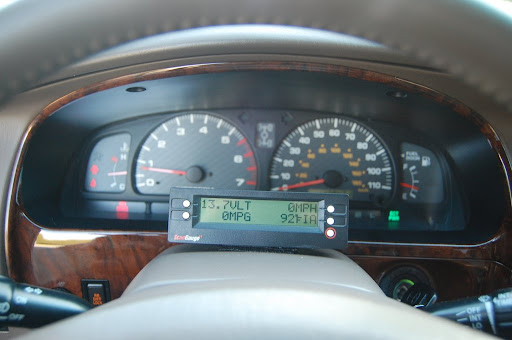

As a fun toy left over from my Tacoma is the ScanGuage II. It's a pretty useful tool for comparing snorkel temps with your buddies or just as a code reader. Every time I hit rough dirt I tend to throw a CEL for an O2 sensor, when I know for a fact that it was replaced just before I purchased it. I can simply reset it with the ScanGuage and I can go on with my life without that pesky light staring at me.
Sorry to hear about your truck but your 4 runner is looking awesome:D
On the scan gauge, if you have tires any size other than stock, the mpg, speed and odometer will be off. The scan gauge is hooked up the OBDII connector which is essential reading ECM unit factory programed based on stock tire size. Unless there is an adjustment on the unit?

Scanguage: there is a setting in the unit where you can adjust it +/- a certain percentage to compensate for tires or gearing. It's easy to just correlate the % to an actual GPS reading. I look at my scanguage for my speed now, i don't even use the actual speedo. But you are correct, the odometer will be reading less miles than I am actually traveling. I'll try to get a photo of the screen for you.
