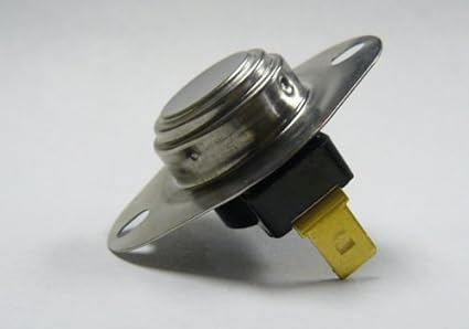

That's not the fan mod bearman is talking about, but that might help a little too. My dometic has a small computer CPU fan mounted at the back of the fridge that blows hot air up and out, similar to the diagram above. It is tied to a temp control switch (for a furnace?) that turns it on at about 90F I think, and has a switch inside that also enables it.

Thanks Bearman and Deuce! For some reason the diagram above didn't show up for me earlier when I posted, but now it's there. I might have to try this at some point, as my fridge doesn't really keep up on propane when it's hot. I even have a PC fan left from another project. I'll just have to source the temp control switch.

Amazon or ebay have Thermal switches cheap.
