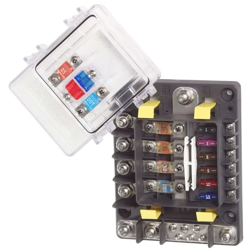

You might consider the Blue Sea 7748 fuse panel; rated for 200-amps (which should work with your battery) and is essentially a fused buss-bar. The larger MIDI fuses work well for larger inputs like the solar and DC-DC (not sure what the convertor on your diagram is, AC input?), the smaller (30-amp max) blade fuses work well for loads. I'd put the Renology shunt on a 7.5 or 10-amp blade fuse to protect the skinny wire.
The whole thing can be protected with your 200a breaker/kill-switch and all of the neutrals can gather on the 7748 before going to the shunt on a single wire.
While it may be less expensive to assemble something similar, nothing will be as compact and easy to access, I think the cost is well worth it.
I've used this for a number of years and enjoyed how compact and easy to configure it is. I have Solar, DC-DC and shore power (at 12v.) coming in, a sub-panel in the truck bed uses the last MIDI fuse. Blade fuses protect circuits for the fridge, lights, a compressor and various DC power-points. The panel, DC-DC, shunt and monitor all fit in a space smaller than a shoebox next to my battery, MPPT and shore-power live nearer to their inputs and are also fused there, but I've never had to mess with those because of the consolidated fusing on the 7748.
Using the common bar, I can have different charge sources running at the same time and all my loads supplied as well. Most chargers are smart enough to recognize the voltage and act accordingly, I don't need to monitor or designate which unless I want to.
On short jumps, from the breaker to 7748 or from that to the shunt, I use sections of copper bar. 3/4"x1/4" bar has a slightly larger cross-section than 4/0 cable and you can cut it and drill it as opposed to crimping lugs onto a stubby section. It takes heat-shrink well and only requires that the posts it links are on the same plane, which isn't that hard to set-up.
I've used BlueSea fuse boxes in the past, and even have a brand new one kicking around in my parts. Didn't know they had ones rated for more than 100a, so I hadn't considered using one for this application.
That 7748 looks like a nice unit. Downside is that it's $203 before tax on Amazon Canada. I already bought the 4 circuit breakers I plan on using for about $160 shipped. One of those would be needed w/ the BlueSea too... I'll sleep on it. I do like the simplicity and cleanliness that setup would bring...
Okay, didn't have to sleep on this all that long - the simplicity and cleanliness won me over. Won't have to bother with the buss bars and three separate breakers. Thanks again for the lead on that unit!
Ordered the 7748 + fuses for it.
The fourth high-amp circuit might come in handy if/when I setup an inverter. Might find a use for the low amp circuits, too. Can always add some more USB ports, 12v charging ports, whatever else.
I think you'll be happy with the cleaner install and easier upgrades--
Breakers for switches are a good call, but fuses are much cheaper. If you design your system well, you won't really use either very often, so quick-to-check and out-of-the-way become chief virtues.
