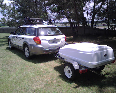

Taking the kids camping this summer in the Superu, taking the trailer along
and want to bring 5 bikes with us.
2 adult mtn bikes,
2 kid's bmx style bikes
and one 3 year old's Tonka bike!
I have a Thule Parkway that will handle the four biggest bikes and the Tonka will probably find a home on the Surco roof rack.
I'm thinking this hitch setup may be better than adding a hitch to the trailer since the weight of the bikes will be better handled by the vehicle's suspension rather than the trailer's.
Any thoughts or suggestions on this one?
TIA

Where you plan to go, can the trailer's tongue articulate into the bike rack? Will the trailer clear the rear-most bike in a flat, tight turn? How about that same turn through a deep gulley or similar?
Superu
The trailer will only be on until we reach the campground which is easily accessible with no significant obstacles.
Once we get there, the trailer will stay put for the remainder of the trip.

This is what my Thule looks like.
With the adult bikes loaded first (closest to the car) and the two BMX kids bikes next in descending order of size, I'm thinking I should have clearance from the tralier.
The trailer box is pretty low since it's essentially just a cargo box on a 40 x 48 base.
