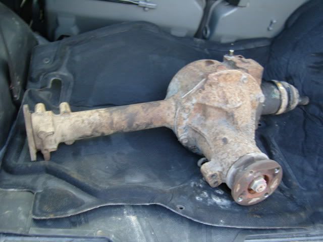

What was the donor vehicle for the steel front differential and housing?
AFAIK there are no vehicles in North America that have a steel centre. They are all aluminium. There are aftermarket housings and people use SJ/Samurai differentials as well.

Root Moose. The steel housing can be found in 5 spd grand vitaras and the steel third in the the same or an XL7 has them as well. check zukiworld there is an article there explaining it all.
Richiezook
Sorry , missed your post , yes in the UK anyway, the Grand Vitara 2.5 V6 petrol and the 2.0l Diesel have steel axles. The 5 door Vitara (tracker , sidekick) Diesel (late version) has them too.
All will have the wrong ratios (probably if you want 5,12) Most are 4.8.
Ive fitted 5.12 diffs into mine (as i had them from my petrol , and ones steel the others an LSD), this also lowers the gearing from 4.8 diffs in the Diesel back down to compensate for the 31" tyres.
