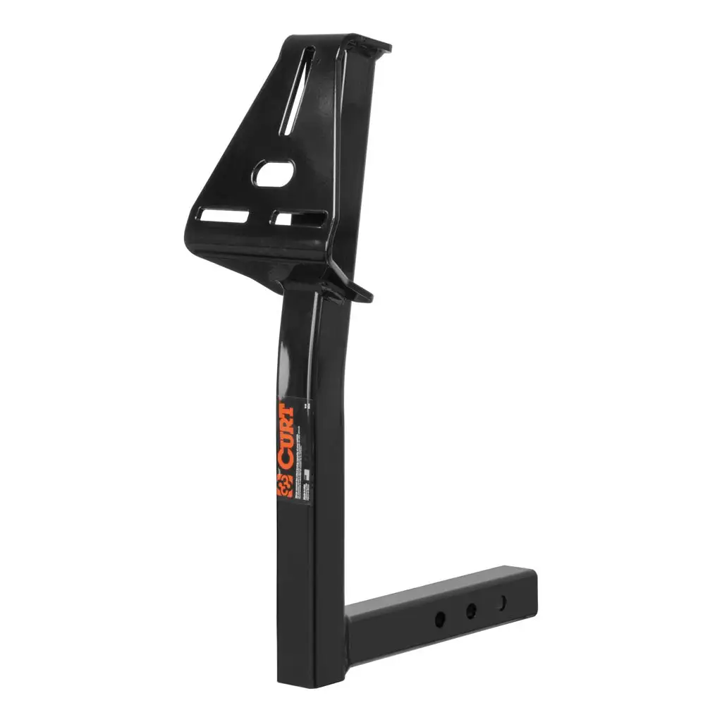

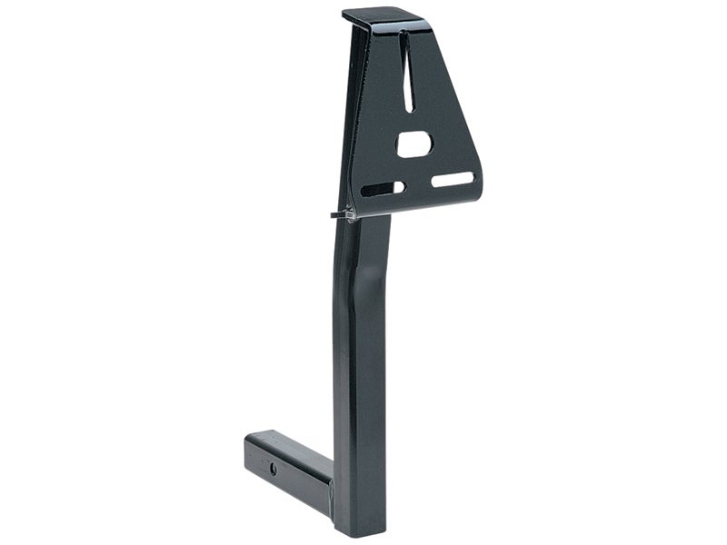

Gotcha. Looks like you could try one of the pre-built spare holders from Curt/Draw-Tite/Etc, but no idea if they will clear that grill guard. And they might be too tall because they seem to be made to work with most of those manufacturers' front receiver hitches which are always mounted low underneath the front bumper. Pictures for reference...
Curt Mfg
Draw-Tite
I'm guessing your front receiver is behind the license plate?
deminimis
Thanks. I've looked at those, but it would block the winch (which I got to use this weekend to get out of my parking spot...no, seriously). I also have a front cam because I can't see the front of the bumper, that I'd like to not block (license plate cam). What I have in mind is building a horizontal tube from the hitch stinger, and then building verticals, etc, up from there. I'd chain and turnbuckle the ends of the horizontal tube to the tow hooks to keep a lid on some of the side-to-side movement that I suspect would occur. Of course, I've never seen anything along those lines, so looks like I may be forging a new path. I have very little wiggle room insofar as it relates to front axle weight. With a steel spare, I'd be too close to capacity when loaded up. With an alumn spare, I'm in better shape. However, the amount of steel it will take has to be taken into consideration too. Due to an odd tire/wheel situation, I'm finding myself with a total of three spares by the end of the week (I'm replacing the front rubber w/ only 12k on them with something more (hopefully) snow worthy, so I'm not tossing that rubber). The front spare would only be for trips to Baja. It will be so far out, that good air for the rad and IC will not be an issue. Thanks again.
