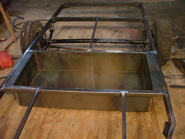

I was out in the shop again this last weekend and worked on finishing up details on the chasis. This included unbolting the axle and flipping the chassis over, finish welding the joints from the bottom side, and adding gussets where the main frame rails were spliced together, as well as where the frame rails bend to form the tongue and where the frame rails and the rear cross member meet.
After that I worked on the under floor storage box. I was able to bend it up and then weld on the end caps. The box ended up being 48" wide by 24" long (front to back) by 10" deep. That ends up giving them 11,520 cubic inches, or 6.7 cubic feet of storage below the floor. This should be great for lighter weight but bulky items.
This week I'll finish weld the gussets from the top and then put the body back on it and make the cut out for the under floor storage. I'll also be putting in the "headliner" and working on the storage cabinets for the kitchen and sleeping chambers.

I have been able to get the two side doors installed, and I'll have to get some pictures of that posted. I guess that I also was able to get the body back on and cut the floor opening out for the under floor storage. The storage box is actually deep enough that you can sit inside with your feet down in the storage box and be quite comfortable. It will be interesting to see if the owner wants to have the bed cushions made in such a way that they would form a seat bottom and back. If they do that they could use a pedestal to turn the floor segment into a table top and escape any unpleasant weather for a card game, or other activity if they wanted.
