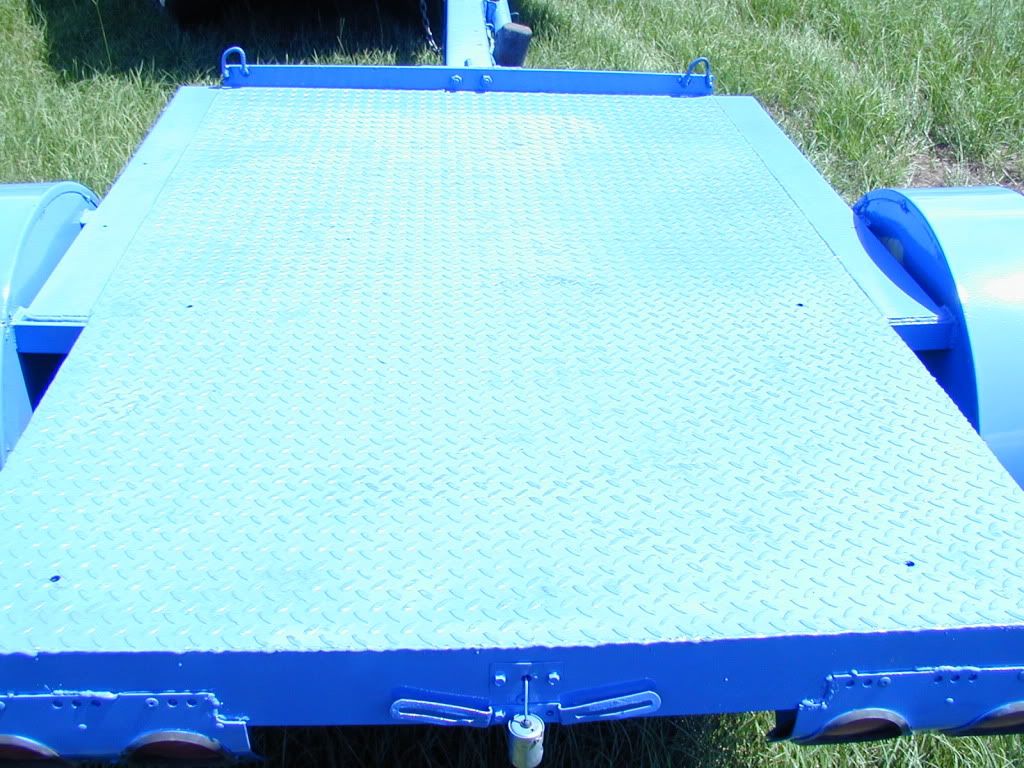

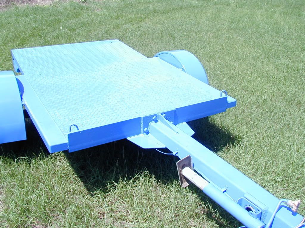

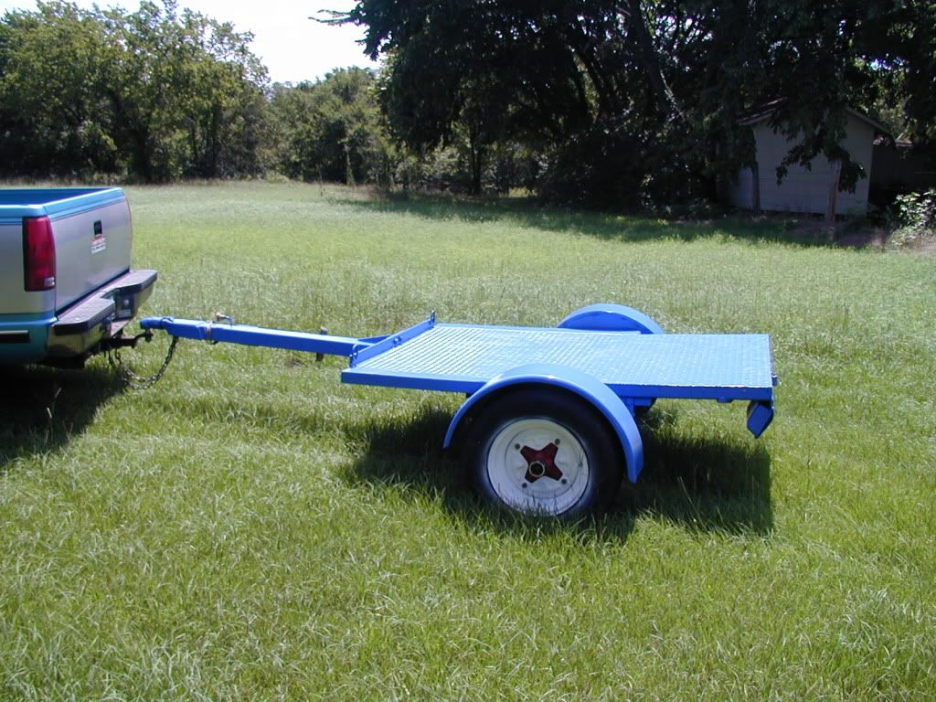

I'm looking at buying this as a base for an expo trailer. I wanted to get your thoughts on it, and whether or not its worth the cost to buy. I haven't seen it in person yet, but it looks pretty heavy duty from the pics. It looks like their might be a slight bend where the tongue joins the frame, but it might just be the pic. My plan would be to take it to a local fab shop and have them add some reinforcement in that area, so I can put a deck there. Hopefully if its bent they could straighten it too
I'm thinking this guy will take around $200 bucks for it, which would be completely awesome provided its not a total POS.

I think it has possibilities...but...
looks like the tongue is bent up

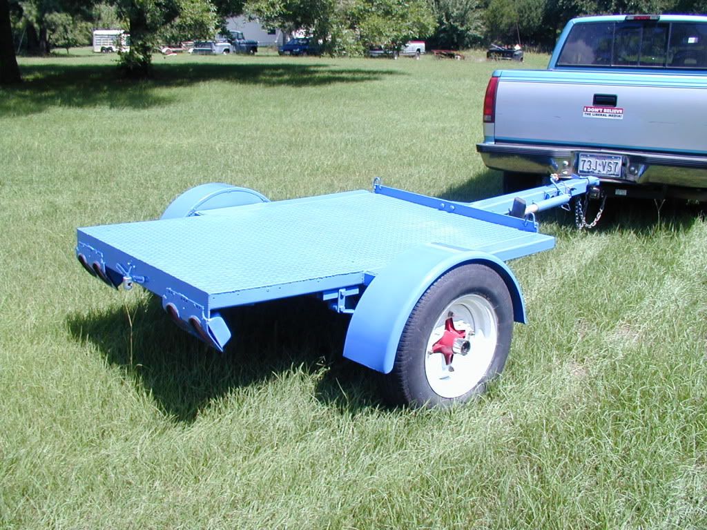

looks like the tail lights are bent down

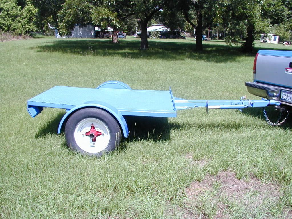

looks like your gonna have to figure out how to get rid of those rims as
teotwaki says
now the up side
looks like it was put together with someone with an idea
it has a bulldog coupler, which has better articulation than a standard ball reciever

I would pass.
Somebody put a lot of effort into it, but as designed it won't stand up as an expo trailer. For example, the springs and axles are light duty and look like something designed to tow a small boat short distances on paved roads. By the time you do the necessary repairs and replace the springs, spring hangers, axle, wheels, tires, fenders, low hanging tail lights, etc., the only thing you won't have changed will be the basic frame.
Better to start with something else.
But that's just me.

Before you bite, check the price if the rims- that alone might dissuade you. I'd pass it by even if it comes with plenty of spare wheels.

Thanks for the responses. I was planning on swapping out the axle and wheels already for FJ ones. I'll probably still go and check this out, but I'll definitely be leery about buying it.

That bend in the tongue is characteristic of a butted tongue design. For any kind of load the tongue tube(s) should be under the main frame tubes to create an overlapping of the tubes at the front of the deck where the highest bending stress is. For a lightly loaded camping trailer the design works fine, but someone obviously overloaded that trailer. I'd pass.
