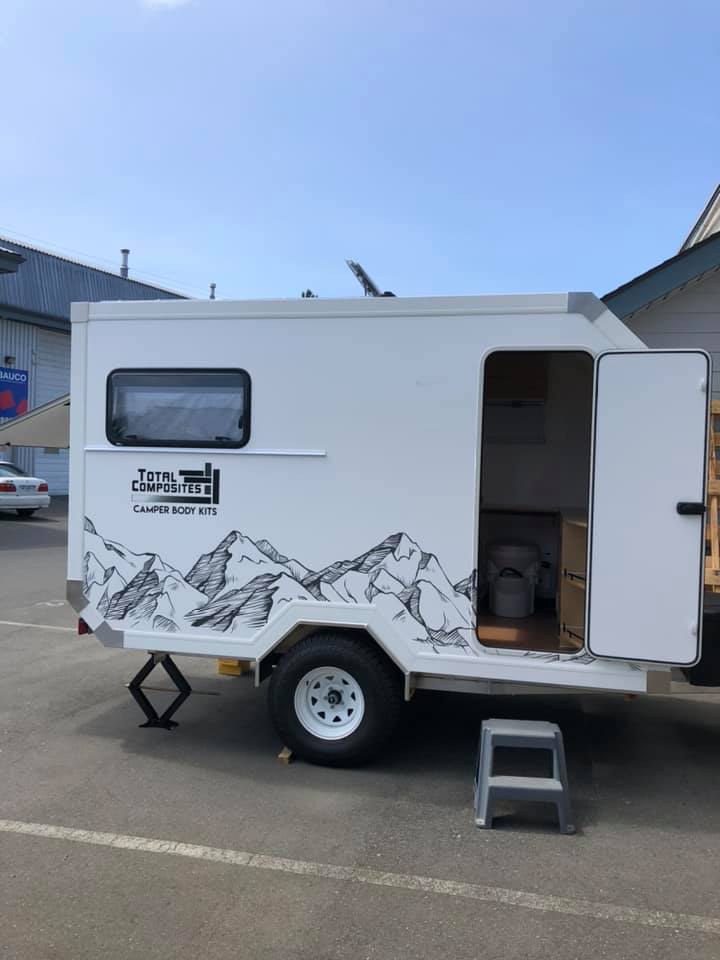

I think I've copied all of the pertinent posts to this thread:
Overview:
True 4 season capabilities
Rugged constructions for off the road adventures
Take it down to South America or up the ski hill. There are no limits!
Build with thermal efficiency in mind
1 year warranty on materials and craftsman ship

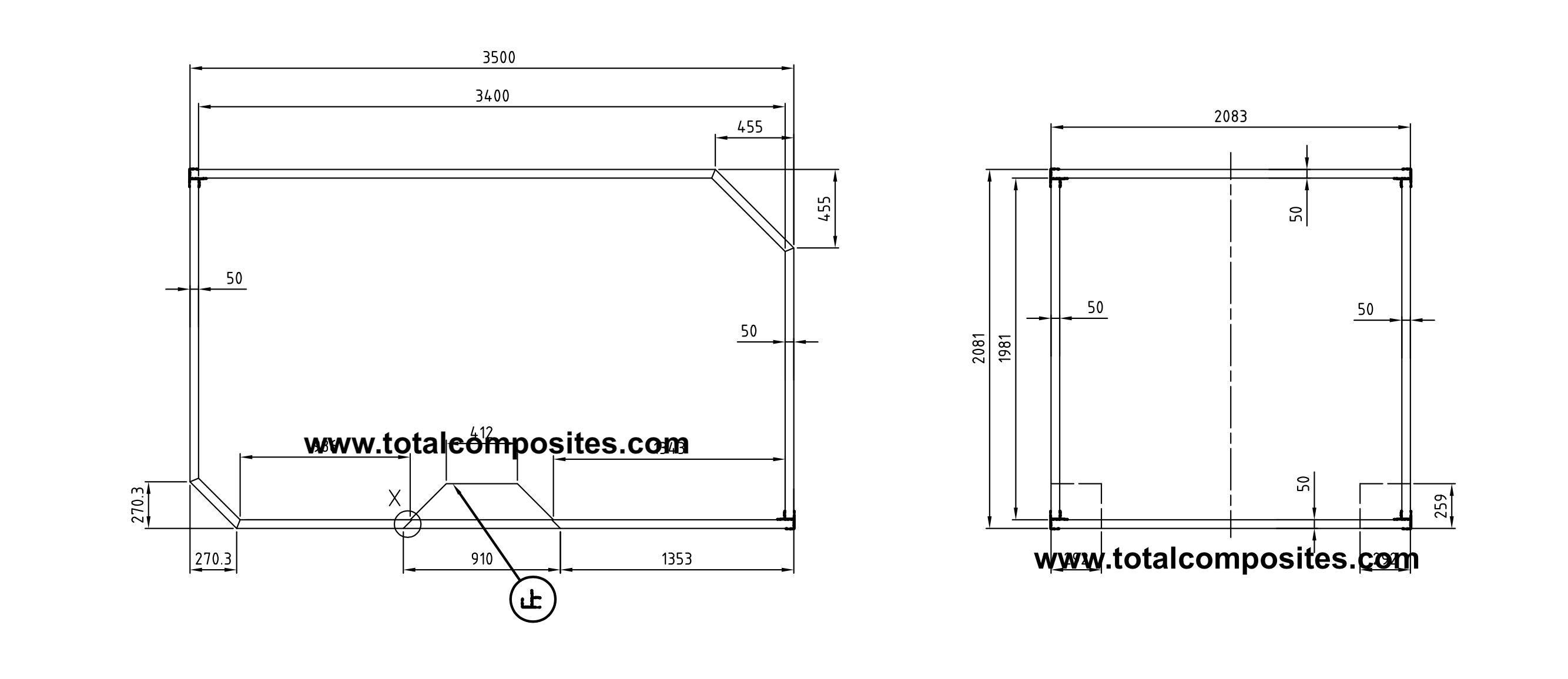

Dimensions:
Overall length 197” / 5000mm
Overall width 82.5” / 2100mm
Overall height 106” / 2700mm
Interior length 135” / 3430mm
Interior width 78” / 1980mm
Interior height 78” / 1980mm
Weight (empty shell including chassis, doors and windows) 1260lb / 580kg
Estimated weight fully outfitted: 800kg/ 1700lb (will take to a scale the next couple days)
Trailer chassis features:
GVRW 3500lb
All aluminum construction (made in Canada)
LED lighting all around
Solid axle with leaf springs (easy to field repair)
Tires Sumitomo Encounter AT 31” X 10.5R 15LT 109R
Stabilizer jacks all around
Aluminum wheel wells (insulated)
Camper body:
Total Composites foam core panels and extrusions
Thermal transfer free
R 12 insulated
2” / 50mm foam core panels all around
Outside FRP skin is extremely impact resistant, woven structure gloss white
Inside FRP skin is smooth gloss white
All corners are stainless steel for added protection
Skylight 500mmX500mm with integrated LED lights, bug screen and sunshade
Two exterior windows 450mmX1100mm by Arctic Tern
Entry door 22”/600mm wide X 63” / 1600mm tall Thermal transfer free, insulated
Panorama hatch 58”/1470mm wide X 42”/1060mm tall Thermal transfer free, insulated

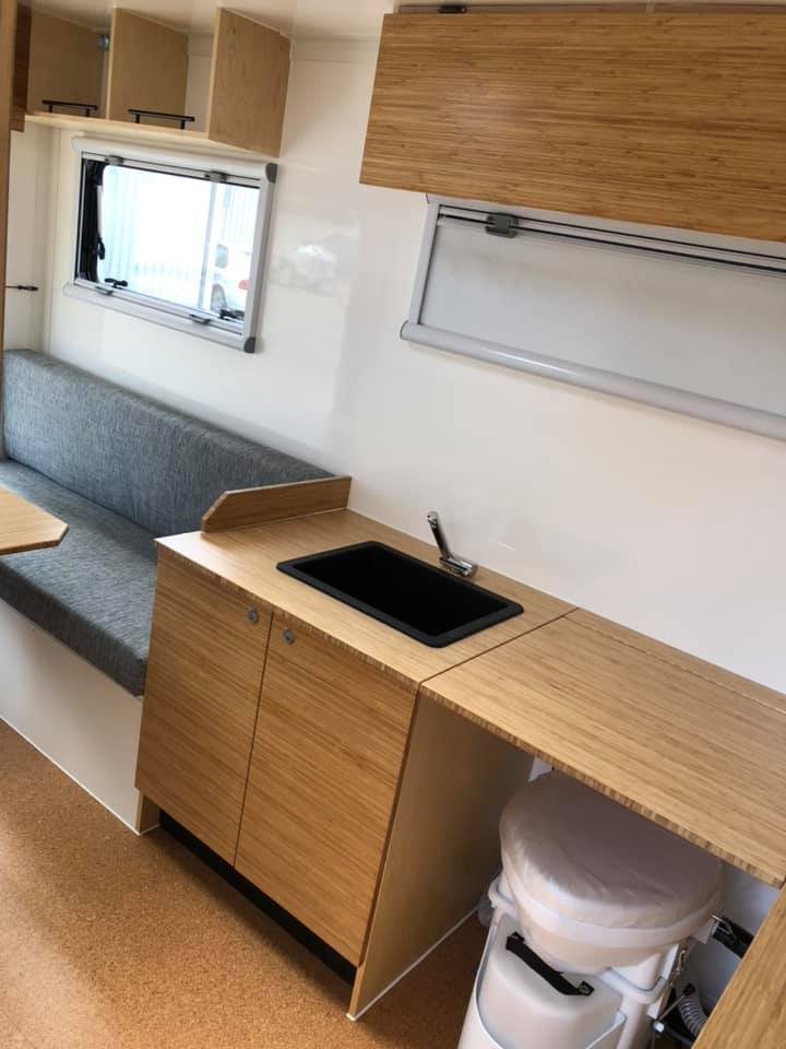

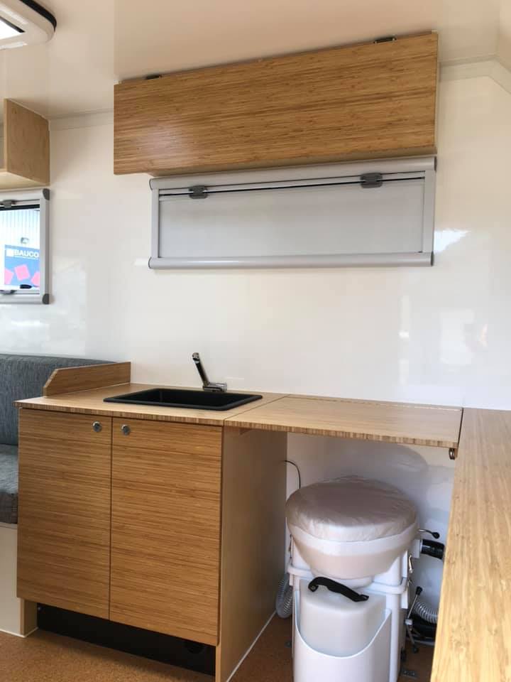

Interior:
All solid bamboo cabinetry
Cork flooring
High end upholstery
Seating converts into Queen size Bed
Amazing amount of storage
45 liter Dometic chest fridge 12V
Water:
12V submersible pump
Water stored inside, protected from the elements (true 4 season)
Electrical:
12V sealed AGM 100A/hour (can be upgraded to Lithium)
Go Power 160W solar system
Heating:
Super efficient Planar diesel heater with 7 litre fuel tank (lasts at least a week in cold weather)
Pricing:
FOB Victoria BC Canada
US$ 37,000.00
CAD$ 46,990.00
View attachment 672783View attachment 672783View attachment 672784View attachment 672785View attachment 672786View attachment 672787View attachment 672788View attachment 672789View attachment 672790View attachment 672791
