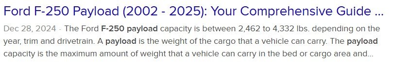

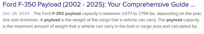

You'll want a 1 ton or at least a 3/4 ton with a payload package to handle 3000+ lbs for a cabover camper weighing 2600 lb dry.
