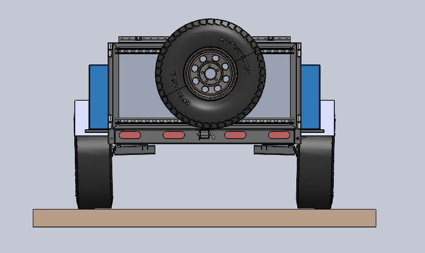

It was a fun thing to design in SolidWorks. To understand the concept above, here are a few screenshots:
