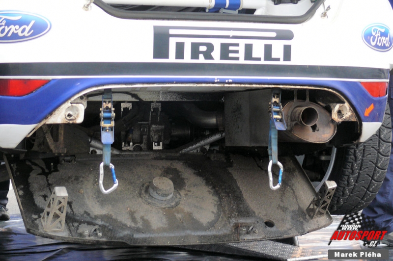

If you get really fancy you can always try a third spare ala WRC:
I admit I haven't even looked to see if there is any room under there, but you could probably stuff a compact spare under there if you tried hard enough.
Wow! I had no idea that spares were mounted there on some of the WRC cars but that makes alot of sense. Because of how low that spare tire cavity hangs I think you might struggle to maintain clearance even with a space saver. Having said that, if I need to be carrying that many spares just to travel on improved roads, I'm doing something wrong.
It would be cool though to maybe remove the spare tire cavity, make the cargo area floor flat and mount the spare under as shown and protect with an aluminum diffuser... hmmm... Sure is fun to dream.
Edit: Just went and looked under the car. The spare tire cavity is even with the rear bumper cover so without reworking the cargo floor nothing will fit under there unfortunately.
