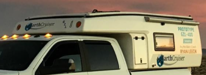

That being said, when Earth Cruiser mount the first one of their GZL400s (on a Ram like mine), you can see that it is mounted very close, The customer used it that way, so I guess 'super close' also works. YMMV

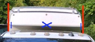

As a reminder, you should not see any movement between the cab and the camper on the pitch and yaw axis, it will all be in the roll axis. So the wider your cabover section is, the more movement on the outboard ends, while the center will stay relatively stationary.
Why do you say that? I think his frame should be pretty stiff in torsion, while mine is not... but I get flex on every axis. Definitely some pitch that closes the gap when hitting a sharp bump with the front tires. My camper is also on poly mounts that have a little travel, but the truck frame and camper will flex too.
I should have add YMMV to that post as I did to my first post. I can only use my trucks (Ram PW, C4500, MB1017) as reference points, and not all trucks.
And 'wow' your truck flexing in the yaw axis, must really effect handling also :oops:

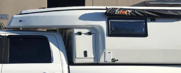

The best gap is the least you need. Mine is 2" on a frame that flexes a good amount vertically, and has poly isolators holding the camper, and I can't make it touch.
This rig is currently for sale on ExPo... what do you think that gap is? It's a lot less than mine... fraction of an inch I'd guess.
