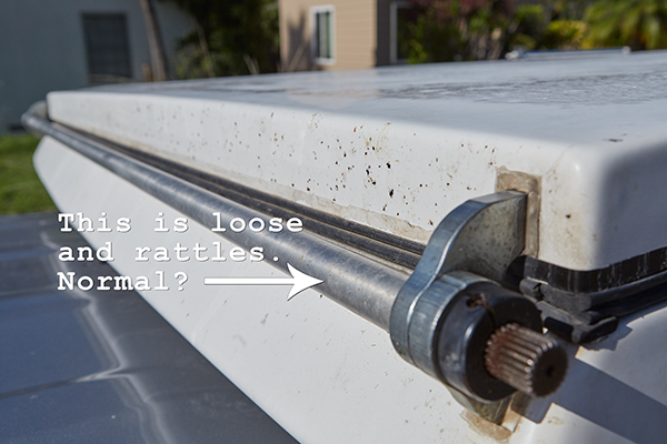

I recently bought a used Flippac. I'd like to know what others are doing for routine maintenance. But I do have two questions already.
1. In the following picture, I've pointed to the metal tube that surrounds the torsion bar. I've noticed that this is loose and rattles while driving. Is this normal? If so, does anyone have an idea on how to eliminate the rattle?

1. The bar - yes it rattles and is loose. I was told to drill a small hole in each end to let water drain.... I have not let, afraid I would get too deep, nick the torsion bar and weaken it
