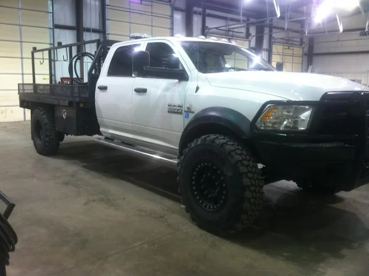

Can't click the video. But most of our 550 brush trucks are nearly stock over here. Simple lift, giant MT's, DBL design front flares fenders and wheels..
And special ordering a gas 550 CC, xl, 4X4, isn't as expensive as many think. Adding lockers is though.

Agree on the cheaper than one might think, i have a 2020 5500 on order now :)
Where are you finding lockers for the 5500 period???

On a F550, any Dana 60 diff will work fine. A Yukon Grizzly locker would be a great choice up front.
Trutracs are available for the Dana s110 rear. Possibly even an air locker if you buy the whole drop out carrier from a junkyard with a scrapped freightliner. Not sure what axles are being slung into the newest CC's.

Trutrac and Detroit lockers are available for the Dana s110 rear. Possibly even an air locker. Not sure what axles are being slung into the newest CC's.
ahhh.. misread your post..
No locker options for the Ram variant
