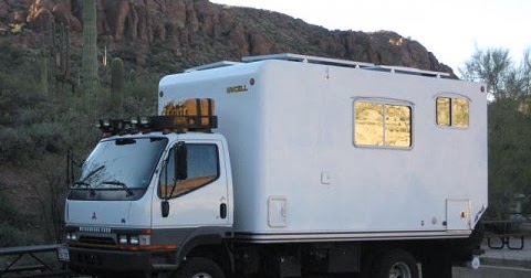

However, with my limited budget (ideally $40k-$70K) there isn't a lot of options for Fusos. I did find a Fuso box truck with an insulated empty box. I'm wondering if I can have this converted to my future travel home. Are there builders on the West Coast that convert insulated boxes to campers?

It has certainly been done and in my opinion, is a valid idea. That was my plan until I 'obtained' a Total Composite kit. There are build threads here on the portal. Some have started with 'normal' (uninsulated) boxes, and at least one had Marathon (I think) build them a box with the side door, etc in it. The commercial bodies are very strong (although with somewhat of a weight penalty as the floors are very heavy to stand up to 'cargo'), and designed for hard use. Certainly starting with an existing insulated box would save you time and money. As far as 'system' builders, I have no suggestions, but if you can find a good local cabinet shop, they are a great resource. I talked with the shop that did the cabinets for my kitchen, and they fully understood the necessity of the added strength and desire for lightweight building for a camper. I had no luck searching for the threads on the portal (>4 years old), but a few photos....

You might try contacting Morgan to see if they will drop ship a Cargo Body to a dealer near you. They might ship a unit without a rear door and supply a blank panel sized to cover the opening. The dealer should be able to mount the Cargo Body on the truck.
You might try companies that work on mobile event trailers to help.

If you get the Fuso with the insulated box, there is no reason you can not cut it down to a more reasonable height, and perhaps mount lower on the frame with a 'step' in the front.
This is a photochop I did of my truck (pre-super singles), back when using the cargo box was my plan.

If you could find an FG with an insulated box in good shape and build your own interior, you have a good base truck to modify as you see fit. If you can find a clean FG with a standard box, consider swapping that box for an insulated box, as insulating a standard cargo box can take quite a bit of time and effort to do properly. Time is money.
I can build you a shell and ship it to WA, but that may not be cost effective for you. A box 6.5' wide x 6.5' tall and 12' long weighs about 400 pounds, empty. This four season box is very well insulated and can be built quite inexpensively, under $3000 in foam and composite skins. This presumes that you have a work space, some tools, time and are keen to DIY the box/truck build yourself.
This is a simple, basic shell, no mounting plates, no doors or windows, no exterior cage, etc. It's just an empty box that requires complete fit out.
