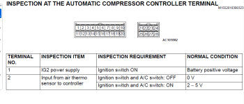

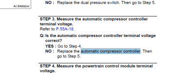

Next in the factory manual, it says:
I cannot find a part number for this thing. Anyone know where or what it's talking about?
Does your vehicle have the automatic AC controls? My 05 Limited has an auto AC setting which will control the temperature of the air to reach a set temperature like a thermostat in the house. It doesn't just control fan speed.
That could be the controller the FSM mentions. That also would be why your AC changes temp. Once the in car sensor reaches the desired temp, it levels off to maintain it.
Changing from Auto will keep it at the same air outlet temperature. Check that next.
