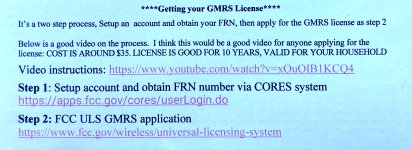

This is the make and model for what we are using for our somewhat isolated island community for our emergency response team communications:
(it is unfortunately a Chinese product)
And here is a little bit of information about getting license to use one:

Thanks for that, and I am aware of the GMRS licensing requirements and wish to fully comply. I kinda' figured everything radio was Chinese these days, even Midland. But as with much of my offroad gear, I still strive for Made in USA products in the hope that anything even marginally better than Chinese junk will lower my blood pressure levels and, perhaps even limit the amount of time I might otherwise spend on cursing, fuming, gnashing-teeth and ranting over some broken down Made in China garbage, that is leaving me stranded--- which incidentally, may also help to prolong my life span as well as that of my dear spouse.../s
