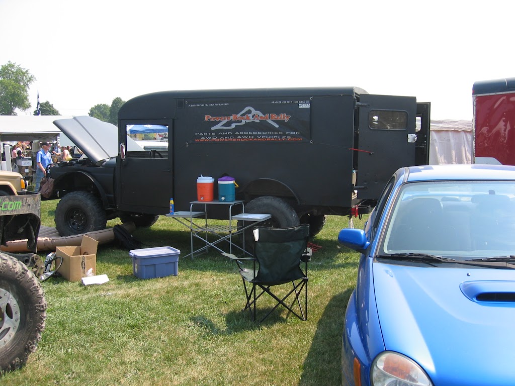

I've got a month or 2 until I get my hands back on the M725. I think I've got the sleeping arrangements figured out by using a fold out bed on the back from a travel trailer.
But.. I still need to work out standing height in the bed area. The total truck width is 85", but I think the box is a little less, but not by much.
The 80" width of the full size 'grandby' four wheel camper pop top looks like it would be a really good fit here.
the truck:
I'm thinking if I grab a used Grandby I can use the top and the opening mechanism with some work. I should also be able to salvage the cook top, sink, and maybe the heater.
Has anyone here tried something like this ? (I know I've seen a few westy tops used here and there). Or any pics of a FWC apart could be pretty helpful
Thanks
Jason
