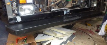

In my new build, I have taken a lesson from modern cars.
The original bumper is a folded/welded C section from 3mm steel.
It looked OK, but is actually not very strong at all.
The replacement bumper is fabricated from 6mm high density polyethylene sheet plastic that is hot bent and hot air welded into a rectangular tube and attached to the front chassis cross member at multiple points.
The hatch is so I can get access to the attachment points and to use it as a storage box, maybe for fishing rods?
Much lighter and much tougher, and no rust, ever!

Is that a one off (and did you make it?) or does some company make them?
I used to have a 5/8” UHMW tranny skidpate on my built Tacoma that was great. It would deform a bit on hits or rocks, but slide over and bounce back. It was just a flat sheet, well anchored, but I can see how a well formed and welded 3D bumper could be good. That stuff is super tough and a lot lighter than steel.
Peter_n_Margaret
One off that I made.
I can do shorter hot bending and simple welding, but I got some help with that one.
I am a big fan of fabricated HDPE. Light tough and almost indestructible.

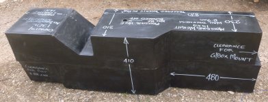

Likewise with tanks.
All my water and fuel tanks are rotomoulded HDPE.
I make the sheet metal moulds and get a local moulder to rotomould them for me. That way you get exactly what you want at any thickness you want.
This is a 130L water tank.
