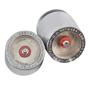

Don't have a picture of it handy, but a nice detail on a homebrew setup I saw here had a trailer axle bearing cap with lubrication fitting on the pivot of the swingout. Thought it was a great idea.
