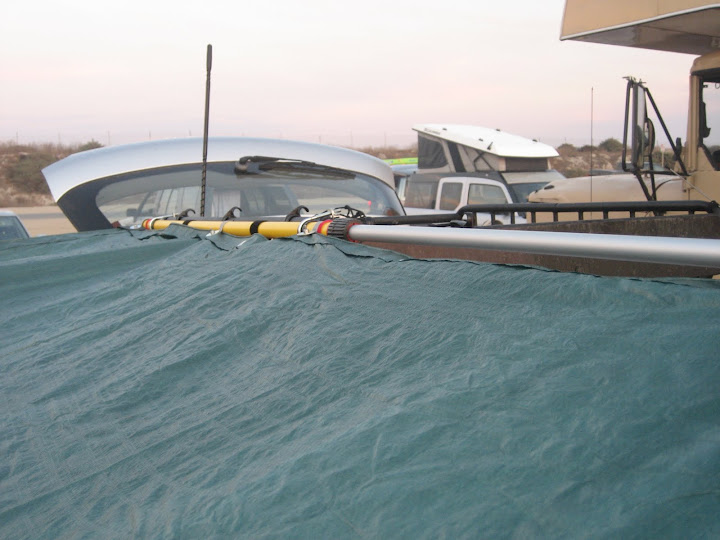

I used an expanding painters pole to give me one side of the awning attached to the car, wide enough to keep things taught. I attached mine to the roof rack because it was there, but you could find a lot of ways to attach a painters pole. Doesn't the Disco at least have the rails running fore/aft? You could probably use U-bolts like I did, only attach direct to the rail.
Here's a couple more pictures that aren't in that thread:
You can see the pole does all the "work", you just need to find some way to fasten it to/near the roof.
