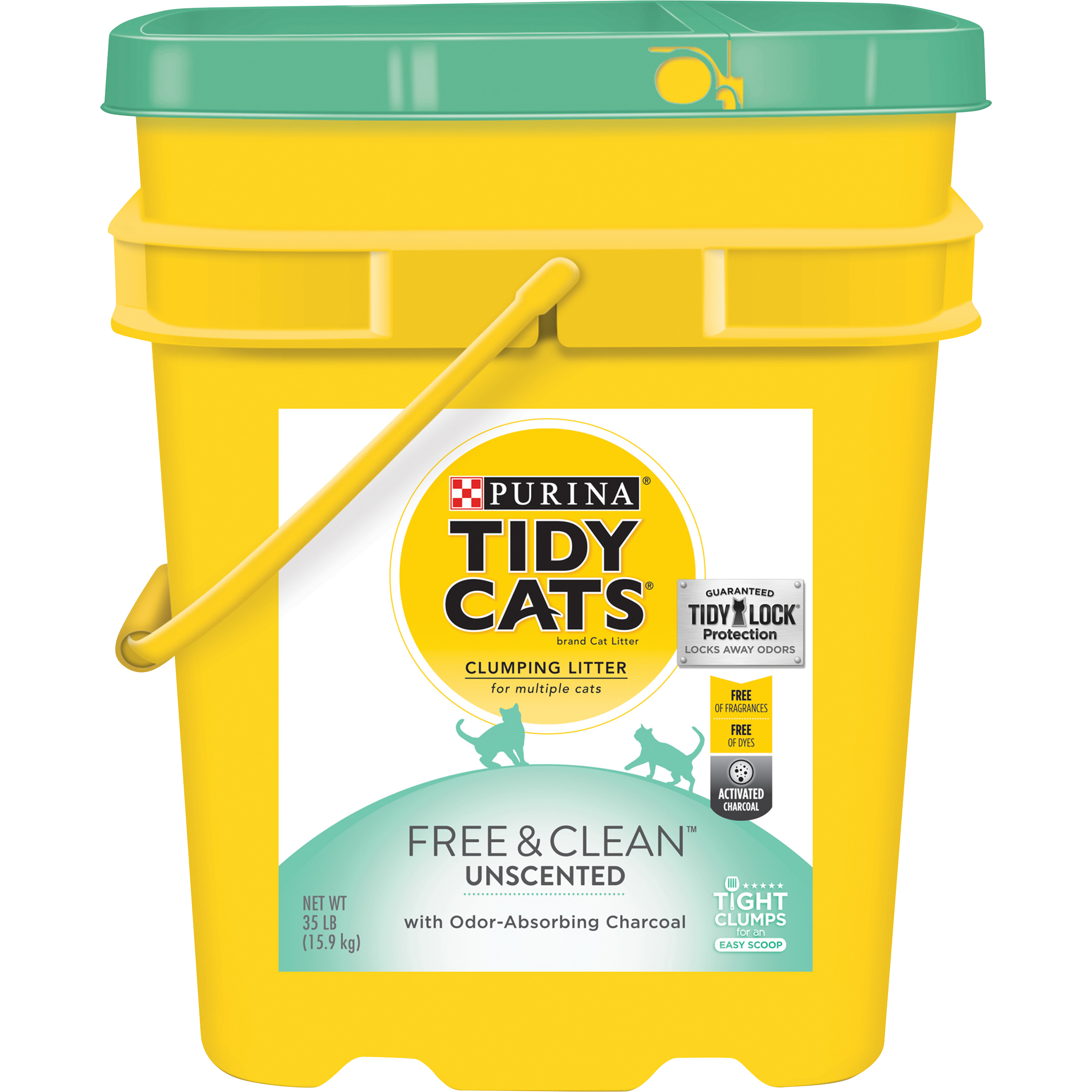

My rig didn't come with the 4 gallon bucket, but instead just the stowage bag. I use a Tidy Cats litter tub, basically a square 5 gallon bucket. I painted the bucket and lid gloss black and use it to pre heat the water passively so that I am over 60 degrees F and I just have a good go of it. Not sure what the flow rate of the pump is, but I am pretty sure it is LOW.... My wife took a 10 minute shower running the thing full time on a 5 gallon bucket of hot water. Pretty sure that is like .5gpm... Whatever though, it works...

If you have the standard red single bottle hottap, if you try putting it in upright it will not fit, however it fits, sideways, in the bag in the Tidy cat 32lb I think it is bucket. It's a tight fit, but it fits. I would have a LOT more room if I just carried the Zodi and left the bag at home. Our cat needs the allergen free stuff and that is the only size I can find so that is what we buy. So I have a few of these buckets...
Basically I can toss the Zodi, some washcloths, and a couple of bottles of campsuds in the bucket and close the lid. I have multiples as I use one for me, and one for my wife. The other bucket gets 4 towels folded up and stuffed into it, plus a camp mirror, and a small shaving kit.
Oh, for those looking to paint a plastic bucket with spray paint, make 100% sure you are using a paint compatible with plastics. I am using Krylon Fusion that includes an adhesion promoter. I scuff the bucket with some medium grit, 220ish sandpaper, wipe it clean with some alcohol wipes, let it dry, and then spray.

I'll try putting it a cat litter bucket sideways. Maybe I'm not getting big enough buckets or the wrong brand.
I am using Tidy Cats Free & Clean 35lb tub. But I think all their 35 pounders are all the same dimensions. I have to use the allergen free / scent free stuff of the cat will scratch herself half to death. Pretty bad allergies on her...
IN the bag, it goes straight in with the handle down. No propane bottles... It is a fit, but not a loose one. There is about 4 - 5 inches of air gap above the bag when stowed where I can stow things like soap bottles, washcloths, camp mirror etc...
This is the type I used. I'll have to try to get the Zodi in again. Thanks.
