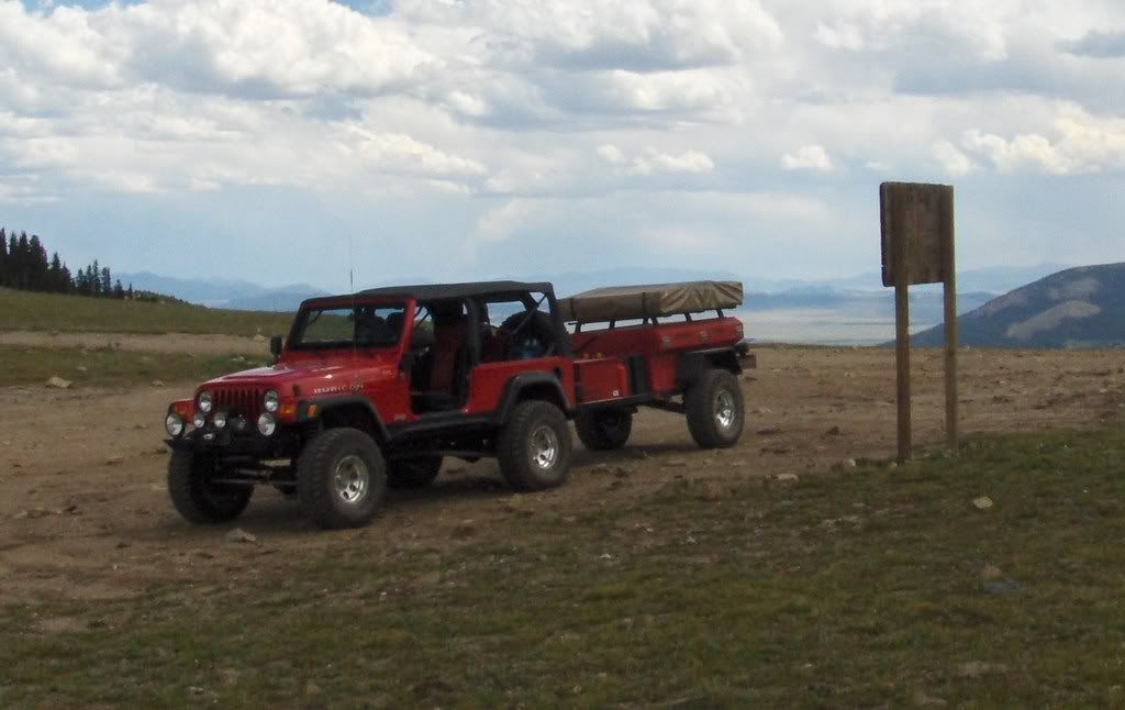

Robert Bills
My '46 Bantam T3-C is set up as a dual purpose scout troop field kitchen (for the adults) and family jeeping expedition trailer. It weighs approximately 600 lbs. empty and 1100-1200 lbs. fully loaded with gear, water, propane and food.
Here are some photos. There are more in the link below my signature.
