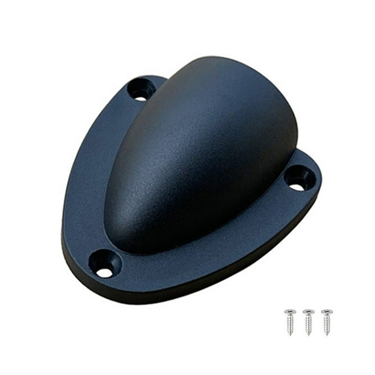

Drill a hole and put something like this over it? Marine vent cover.
Nylon-Wire-Cable-Vent-Cover-Clam-Shell-Clamshell-Vent-Ventilator-Through_82e7642b-ff52-45c3-94c5-c0e2cc144dba.e410f04ea1948954c72741b6354e181c.jpeg
