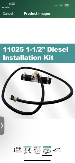

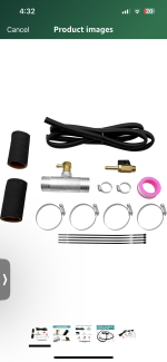

I have a an 8ft bed and am purchasing a 6.5 camper. Long term I am going to putting on a custom tray with a garage and tool boxes.
For the time being the manufacturer is making a box that will sit on bed rails 22in wide in between the camper and cab. Make it like a 8ft camper and provide extra storage.
Under the custom box will be some dead space. Thinking about a hatch in bottom box to reach a in bed gasoline tank for my 7.3 gas ford. Add 36 gallons.
Can I use a in line gravity fill like a diesel set up. There will be a valve to shut off fuel feed.
Curious if anyone has done it? Or negatives
