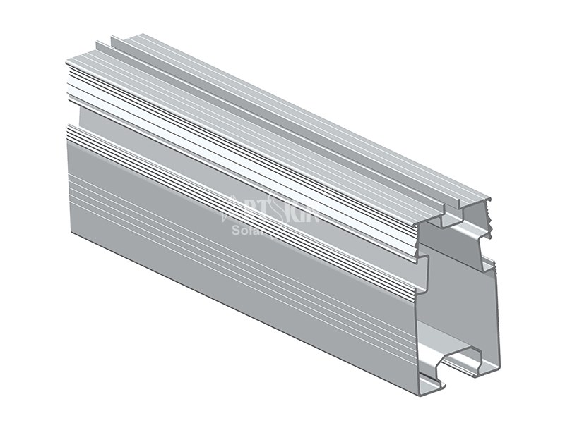

I recently acquired a foot of a solar panel mounting rail. New, 8ft of extruded aluminum rail is dirt cheap. The mounting rail has more mounting points than anything I've seen offered by RAM etc. However, the kind I acquired uses odd, metric, one sided t nuts. I'm currently looking at other installs I see and trying to acquire more options.
I have tried ball mounts but most of the mounts I have used wobble or vibrate. This style of mounting bracket gave me an idea to still use the ball system but use 2 or 3 points of contact to remove the wobble and vibration.
Here are just a few of the hundreds of designs:
China Solar Mounting Rail EG-TR-MR40B Suppliers, Manufacturers - Factory  Direct Price - Egret Solar
China Manufacturer Price Solar Panel Energy Mounting System Aluminum Rail  For Solar Panel Mounting| Alibaba.com
Aluminum Alloy Solar Mounting Rails For Solar Roof Manufacturers
