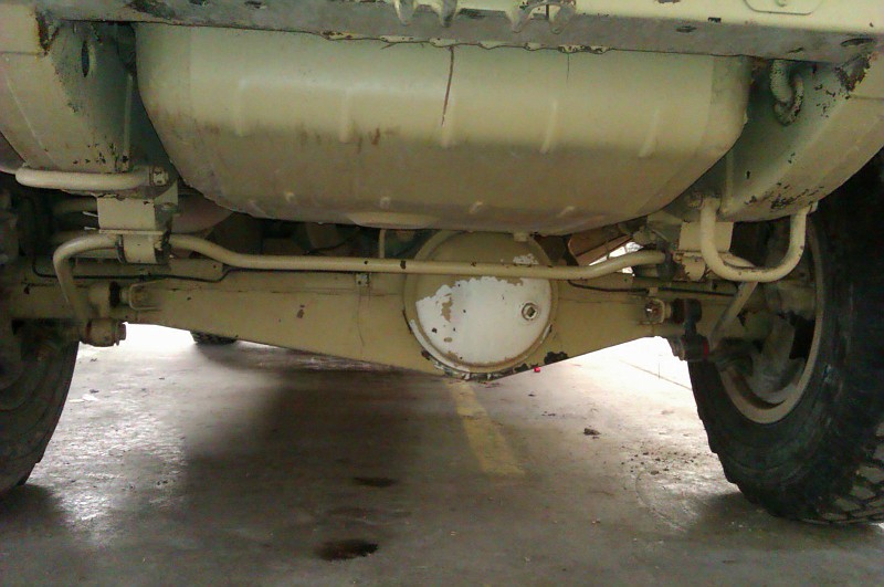

But the wolf version looks like it's got upgrades too, like there is something weldet on it below.
Maybe they let me keep this picture:

Is that a Wolf 90? That’s a Rover rear axle with stiffeners added. Old 109 1-ton trucks had that.
I thought all Wolfs were 110’s and they would have SAilsbury axles out back.
Those “jate rings” on the frame look familiar... I have them on my 110 as well. Simple but effective. Of course, they are always buried in the mud when you need them... I put a strap on and throw it in the back before I go out.
I have a Dixon- Bates rear recovery point I switch with a class III receiver as needed.
