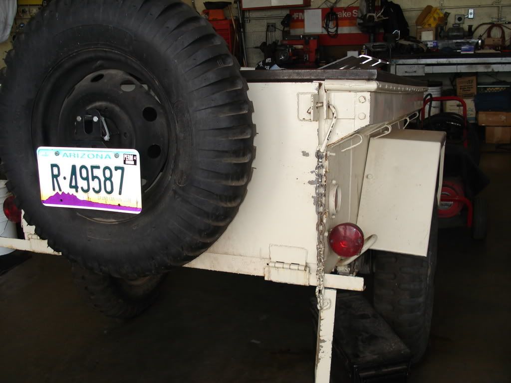

first picture is the trailer being used for the first time after a new military tires were installed,spare tire carrier was installed on the tail gate and new wheel bearings and seals were replaced.

my first spare mount was salvaged from a rav4 I have-
I modified the bolt mounting pattern to fit the military wheel pattern. Soon I found that with the heavy boiler plate and spare, opening the gate will increase my muscle mass in a hurry...

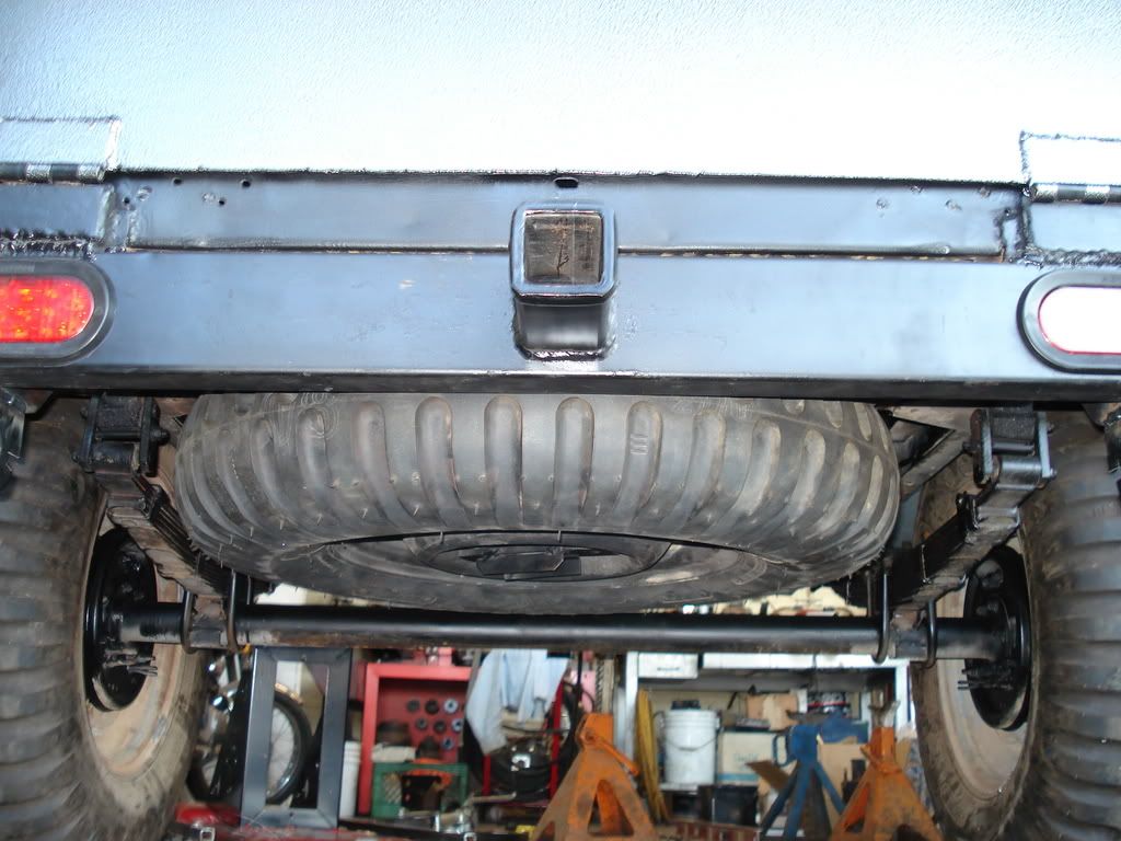

Side view of the tire mount- note the frame is off and another favorite mod is in place, the rear trailer retracting, hight adjustable leg support. (one on each side).
this mod allows you to adjust the rear hight of the trailer in an uneven terrain. the front is adjusted by the wheeled trailer jack, also retractable.
this pic shows the hight clearance- tire is well tucked under. also note the new bumper w the LED'S, and the rear supports deployed.

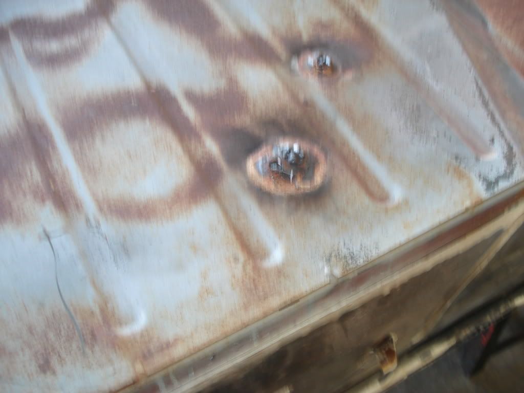

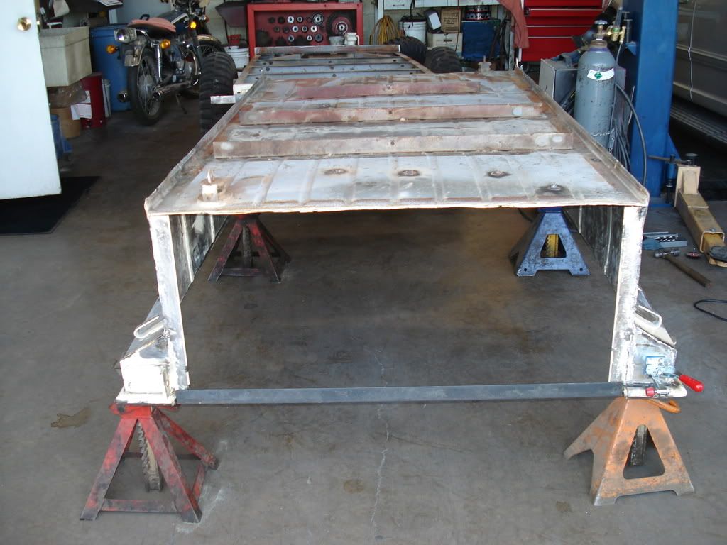

the trailer was strip down first down to the tub and frame,ground to bare steel bullet holes filled, pounded the sides as best possible and invested many hours tring to straighten the top rounded rail- some success, but its still bowed.

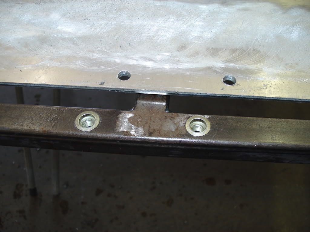

Lid build-same frame design as many of the forum guys did- why mess with success? I did use a thick sheet of aluminum about 1/4 inch or so thick- i got it for free from a friend of mine along with a thick belly guard of a f-350
wait till you see what that turn into!!
I had to cut and tig weld(outsourced) and grind the lid since the sheet was not large enough to cover the frame width wise-still have planty left for some other projects.
I liked how stong the lid is and built a rack to support the RTT and few other items.
rack is removable- a nice feature!!
Can you give me some info on those inserts, like what they are called and where you got them, they are super cool, looks like a great lid man!
