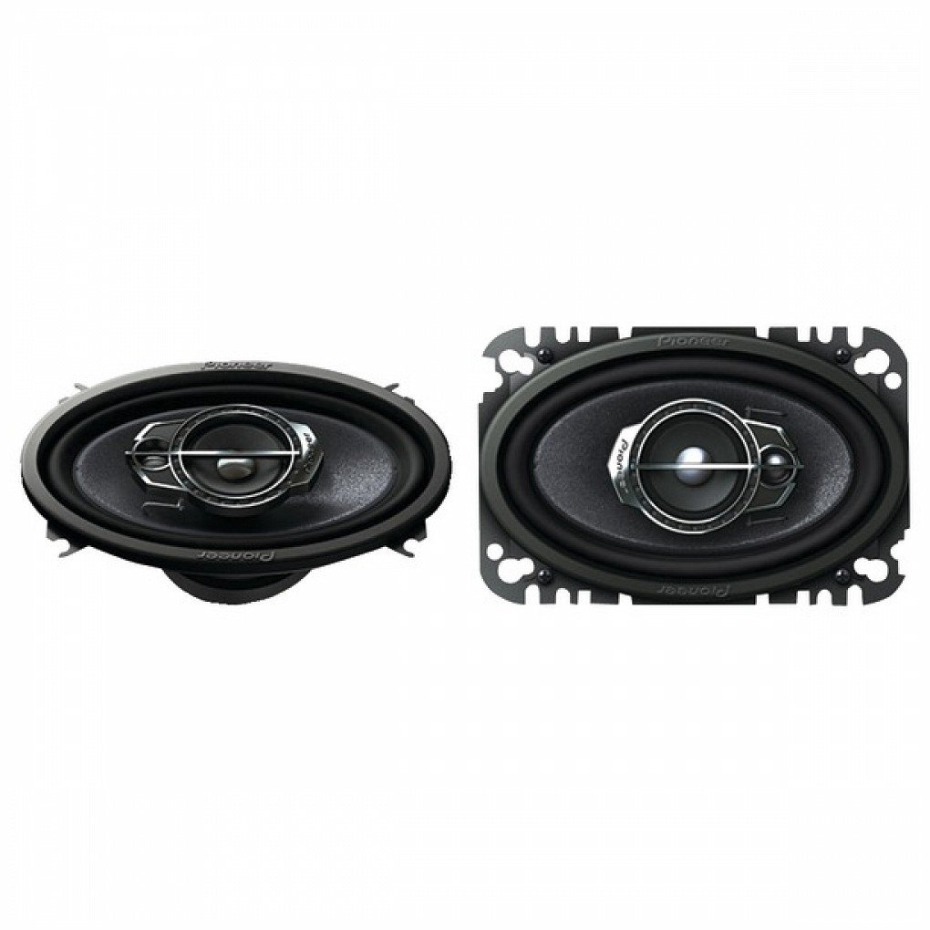

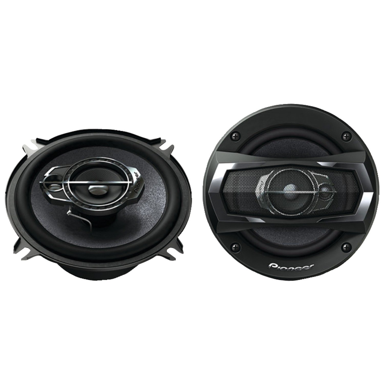

This is what I'm looking at now, based on several speaker reviews:
http://www.amazon.com/gp/product/B00A0LZZ9U/ref=ox_sc_sfl_title_2?ie=UTF8&psc=1&smid=A2NYACAJP9I1IY
http://www.amazon.com/gp/product/B00CYSQRSA/ref=ox_sc_sfl_title_1?ie=UTF8&psc=1&smid=A17Y7218I8U3RT
