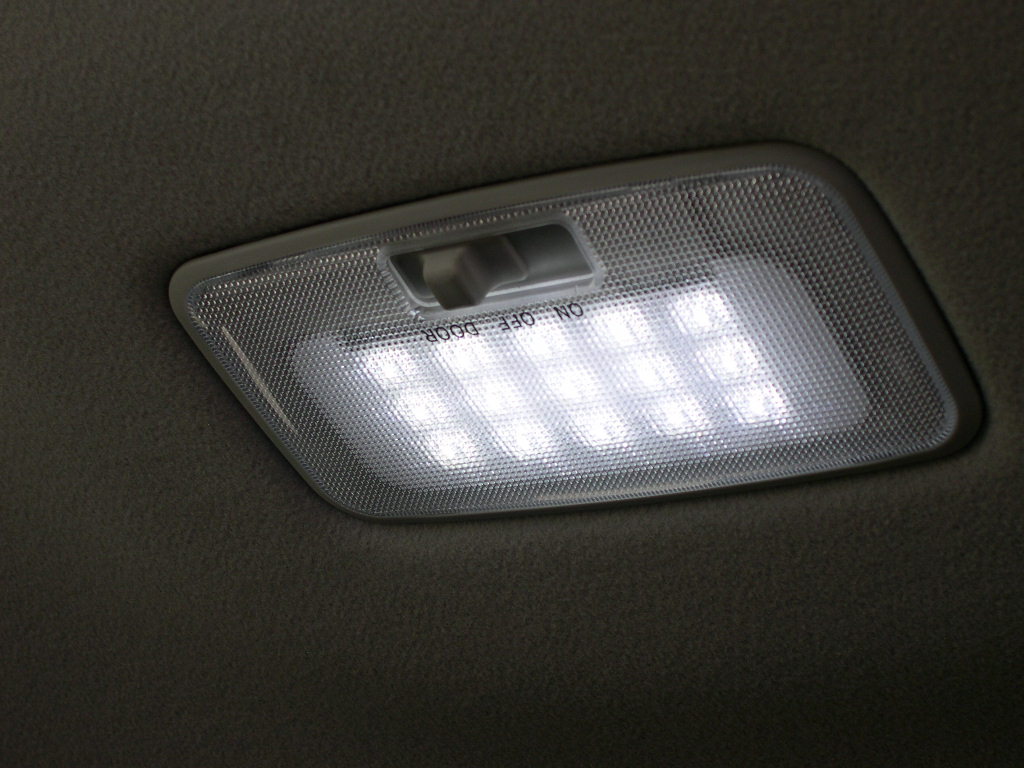

I bought three of these kits from http://www.ijdmtoy.com/ which have some bulb adaptors and two little LED panels with double sticky on the back. About $16 per box.
One LED panel
First thing that I did was to combine two of the wire plugs onto one bulb adaptor and solder the leads.
Installed
Illuminated

I got the 6led bulb and it is reasonably brighter than stock for a decent price.
I also replaced the map lights with 4led bulbs. It all looks a lot better!

How's the brightness compared to the standard bulbs?
Brighter whitish-blue instead of dim-yellow. With the two little LED panels the light is spread out more.
For double the $$$ you can get the Ozniums at http://www.oznium.com/thin-led-domelight
Here are the numbers:
Voltage at the terminals: 12.3 Volts DC
Festoon bulb: 615 mA current draw
Two LED Panels/ 24 Leds total: 170 mA current draw
The festoon bulb got so hot I could not hold it. It is generating 7.6 Watts of heat. The plastic near the dome light rates the fixture at 8 Watts.
The 24 LEDs were at 2.1 Watts total which is less than 0.1 W each LED.
I wish I had a good way to measure Lumens. When I stuck the festoon bulb back in to measure the current it was so dim as to be laughable when compared to LEDs.
