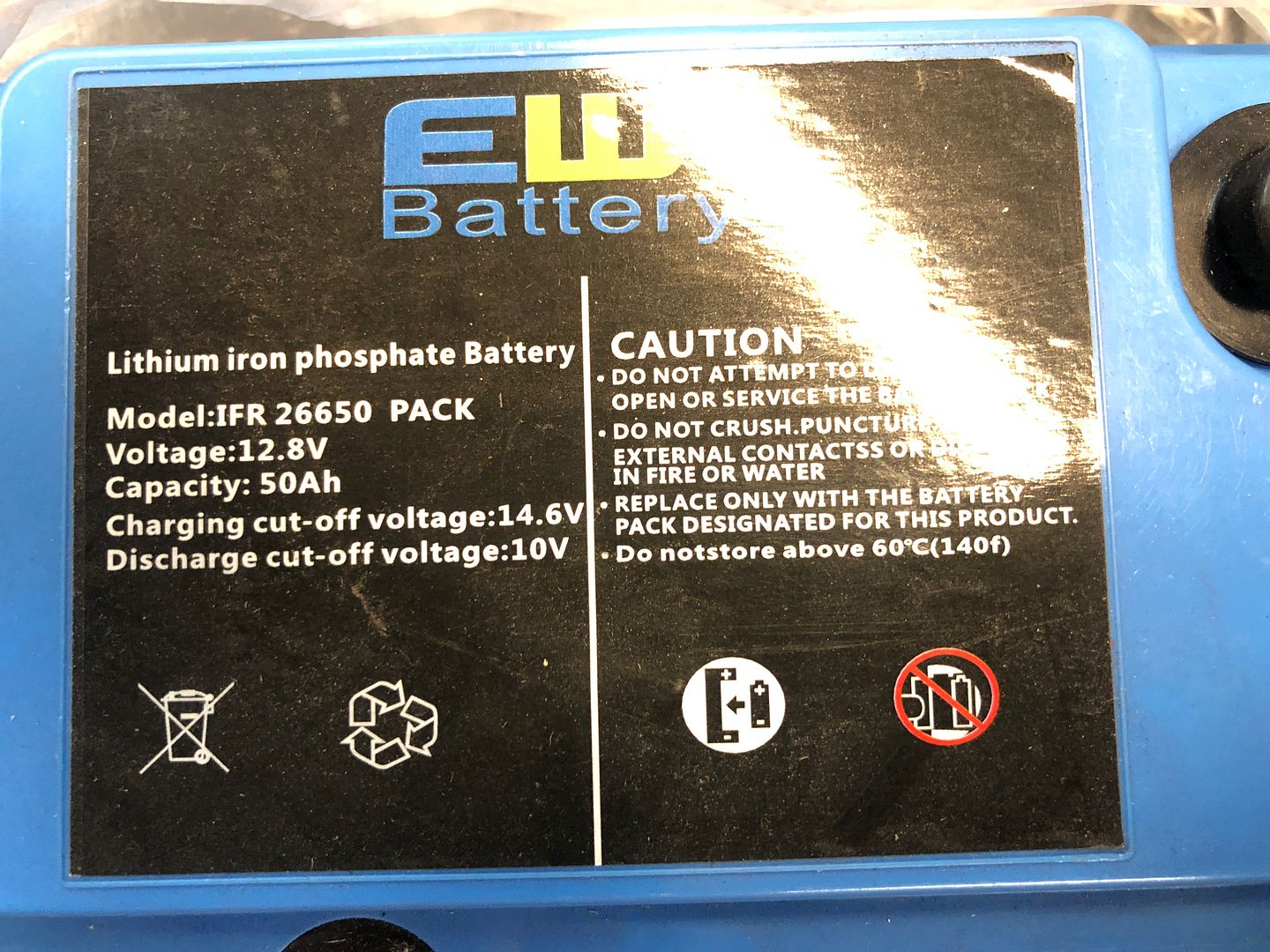

Hello, I have two 50ah batteries that are new drop in replacements for cars. They are light, compact and have a BCM for under/over charging.
Can these be used with a in my TJ to replace my current single battery? I'm worried about discharge rate, my Warn XD9000i can pull 300+amps.
I here these are "miracle" batteries, so I'm hoping these will do the job. They are light on specs, for instance my TJ says a 500cca batt is the minimum. Does anyone know how to get these specs? here is a pic of the battery:

The specs I found on ebay, the ewt 50ah lifepo4 maxes out at 50 amps continuous discharge. I could not find if it had a pulse discharge limit. From the description it said they are for wind solar storage applications. On youtube someone took one apart its a 4s 15p made up of 26650 cells. The cells didnt look like the a123 26650 cells which are extremely powerful, 4 of those cells can jump start a v8.
You can find the specs for the bms on alibaba (100A Li-ion/Lifepo4 battery BMS/PCM 4S Bluetooth bms) it says the over current is 150 amps. This is the bms located inside the battery that was taken apart. Its a large bms with a huge heatsink and looks like it can handle high amps at least in short bursts. At worst it will shut down before it damages the cells.
But on the notes I see the max temperature to store it is 140 degrees. Inside the engine compartment it probably gets hotter then that, that might be the weak point. Lifepo4 don't like it too hot or cold.
