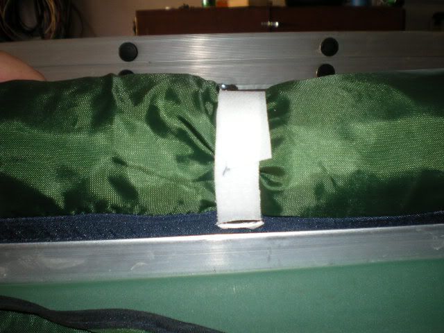

Here you can kind of see what I did. Basically, I installed the changing room on the RTT. You are looking at the bottom of the tent 'overhang' when deployed, or the top of the RTT when it is closed. I rolled it up tightly around the perimeter of the tent where it connects to the aluminum railing. I then used my trusty pocket knife to cut a small slit in the thick blue fabric, just wide enough for the velcro strapping to slide through. The blue fabric is very thick, and there should not be an issue of ripping where the velcro goes through. The straps do not need to be very tight, since the changing room material is easily compressible.
Here you can see the small slit in the blue fabric.
Just another shot, if you look closely, you can see where I added another strap to hold the stake bag next to the ladder for the changing room.
I dont have any in use pictures, but you can imagine how it works. When I have no need for the changing room, it just stays rolled up neatly out of the way on the bottom of the overhang. When I need it, just un-strap the velcro, let it roll down, and set it up as normal. The changing room material compresses very easily, and the cover fits on with no problem. In fact, I will be doing a very similar thing to the cover itself, since it always hangs down over my rear passenger door (where I access my fridge! ). It will be nice to roll it up out of the way when the tent is deployed.

I have only used it once, and it worked great. Currently the RTT is on a boat with all of my other wordly posessions heading for the US, so I only had a little time to try it out.
I havent noticed any frayings where the slits go. The changing room material is very lightweight (and the slit fabric is thick), so unless something strange happens, there is no reason for it to stretch out the slits that I could see. Once you un-fasten it to use it, the slits are no longer in play and it works just as normal.
