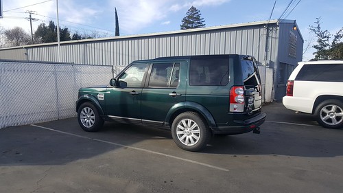

Meet Giles, our family watcher and guide. He’s a 2012 LR4 with the HD and Lux packages purchased at just under 63K miles. The plans are to build an every-day driver that can go just about anywhere, and most importantly, to actually take it everywhere in the western states.
As purchased
Now

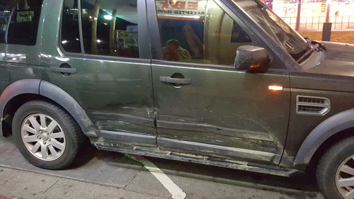

Our 2008 LR3 which met an untimely demise at an intersection mere hours after a bumper installation. Fortunately, many of the aftermarket parts are swappable.

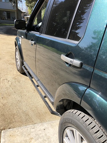

First up on the installation list is transferring the Tactical Rovers sliders that were on the LR3 to the new truck. These sliders took a direct hit from another vehicle with only 1/8 of an inch in deformation. Strong stuff. They’re heavy, but worth it. Special thanks to Zelatore and NCLR for helping with the installation.

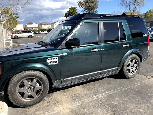

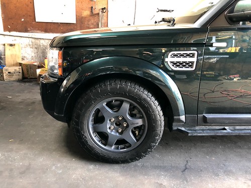

The next day I picked up a set of used Compomotives with Cooper Discoverer tires. The new size is 30.5” and have about half tread life on them. Also, they’re not the LT rated tires. I’m hoping I can get a year out of them before switching to something a little bigger.
First time off road. We had a muddy day out at Hollister Hills SVRA with a couple of other trucks from the NorCal Land Rovers group. This was more aggressive terrain than we had done in our last truck, especially once the slippery mud was factored in. It was also my first time airing down. Happy to be back on 18s instead of 19s. Here’s a pic on our way to Top of the World.

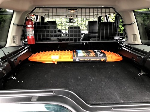

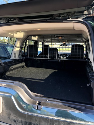

We ordered the tubing and connector from EZ Tube and the parts came ready to fit. The first design removed the center cross brace that runs perpendicular to the tailgate. This proved to be problematic because the two-piece top wouldn’t remain lined up over the center bar and wasn’t supported. I ended up adding the cross bracing under the top and the flex was eliminated. We also cut out the corners in the towards to front of the car in order to install a dog guard. The dog is happy back there and I think it will come in handy when the family is all packed up and we don't want thigs flying forward into the cabin.
The plan is to use Front Runner Wolf Packs, four of which will fit perfectly underneath the platform.

For now, the maxtrax will go on top of the storage platform until I can get them on the roof. I also mounted the fire extinguisher on the back of the dog guard, although I'm not sure if this is a good location.

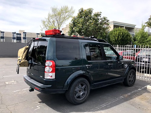

Since this is a daily driver I needed a low profile rack in order to fit in most parking garages around here, especially the one I use on a daily basis at work. My LR3 had the OEM rack, and I had to cut it down in order to fit. Based on these needs and Ray’s experience, I ordered the Prospeed rack and plan to install FarmTek flooring.
The roof rack arrived from ProSpeed via Lucky8. I didn’t realize I needed the OEM short rails in order to mount it until it was already here. Sigh, and not my wallet is a little thinner.
Overall, I love the design, but I do have some quibbles with the execution of the fairing. The Velcro was already peeling when I pulled it out of the shipping box, but I was able to sort that out with some 3M adhesive. The passenger side fairing was so that the screws will not line up if the lip of the front portion is under the fairing. Also, I cross thread one of the screws as I was figuring this out, and the nut insert that was set into the plastic fairing popped out. Also, there were no matching nuts or washers for the screws on the side of the fairing. Since I was running low on time and tools, I opted to mount it with the lip on top and sort it out after the trip.
Other than the fairing issues, the installation was super easy and took less than an hour. As promised, the rack has very little wind noise.
The FarmTek flooring arrived, but that will have to wait until after the trip for installation.

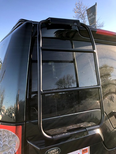

The poo palace necessitated transporting trash that I didn’t want in the car and I realized this would be the perfect excuse to use the Trasharoo I got for Father’s Day a couple of years ago. Hmm…where to mount it? I’ll get the swing outs eventually, but for now…Front Runner Ladder time. :)
Note: During the installation process, one of the insert screws for the rear license plate light cover also popped out. This time, it was not due to my cross-threading, but just came out when I attempted to loosen a nut. Can I just call it at this point and say that metal insert screws in plastic is a crappy design?
I mounted the shovel with quickfists and the jerry can with ratchet straps. I was going to go with Rotopax, but I know I’ll want a swing out later, and the local 4WheelParts only had one of the 2 gallon packs in stock and one of the correctly sized mounts. Based on a quick chat, he steered me towards the jerry can and ratchet straps. I stopped by Home Depot and picked up a rubber doormat for $9 to keep the can from scraping on the roof rack.
