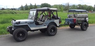

My little home-made military style trailer has the same track width as my 46 Willys. So narrower with the TJ, and even more narrower than my JLU. Tub is 40" x 50". 99% of the time it has been pulled by my TJ when overlanding.
Build thread if interested: https://www.jeepforum.com/threads/mini-harbor-freight-type-trailer-ultimate-build-up-thread.1180456/
I've never had an issue with having different track widths (TJ vs. trailer) on the trail or on the highway. I had the tub built tall so I could stack two 8-gallon Rubbermaid Action Packers on top of each other. The lid hinges on the passenger side, and sometimes yes it is a bit of a pain to reach stuff against the passenger side of the tub. Doable, just a pain sometimes.
