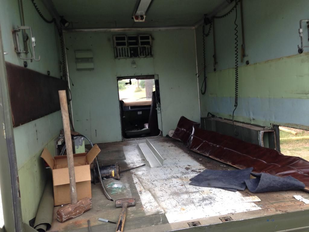

Right now I am fine with the way the truck runs/drives I just drie it around when I am on my days off I like it a lot I am still trying to figure out a lay out of what I want to do. Might just do 35s and a small lift.

I am still trying to figure the lay out of the box just sit here thinking about it all the time.
I do know I am putting in a regular air conditioner and I will make something that put air into the cab.
And I am putting in an arb style fridge and queen size bed also probably doing a wet bath for the bathroom.

I am trying to fit a wet bath, stove top, sink, and bed into a 9x6 box...
I am also thinking of building this to travel 3,000+ miles around the us. So I need to have a shower and toilet I figure I can do a 30x48 wet bath, queen size bed that double as table, 2 burner table top, single sink, fresh water will be stored under one bench and battery bank will be under the other bench.
