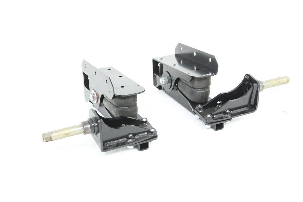

In regard to axles, how about these?
https://www.etrailer.com/Trailer-Axles/Timbren/ASR1200S01.html
